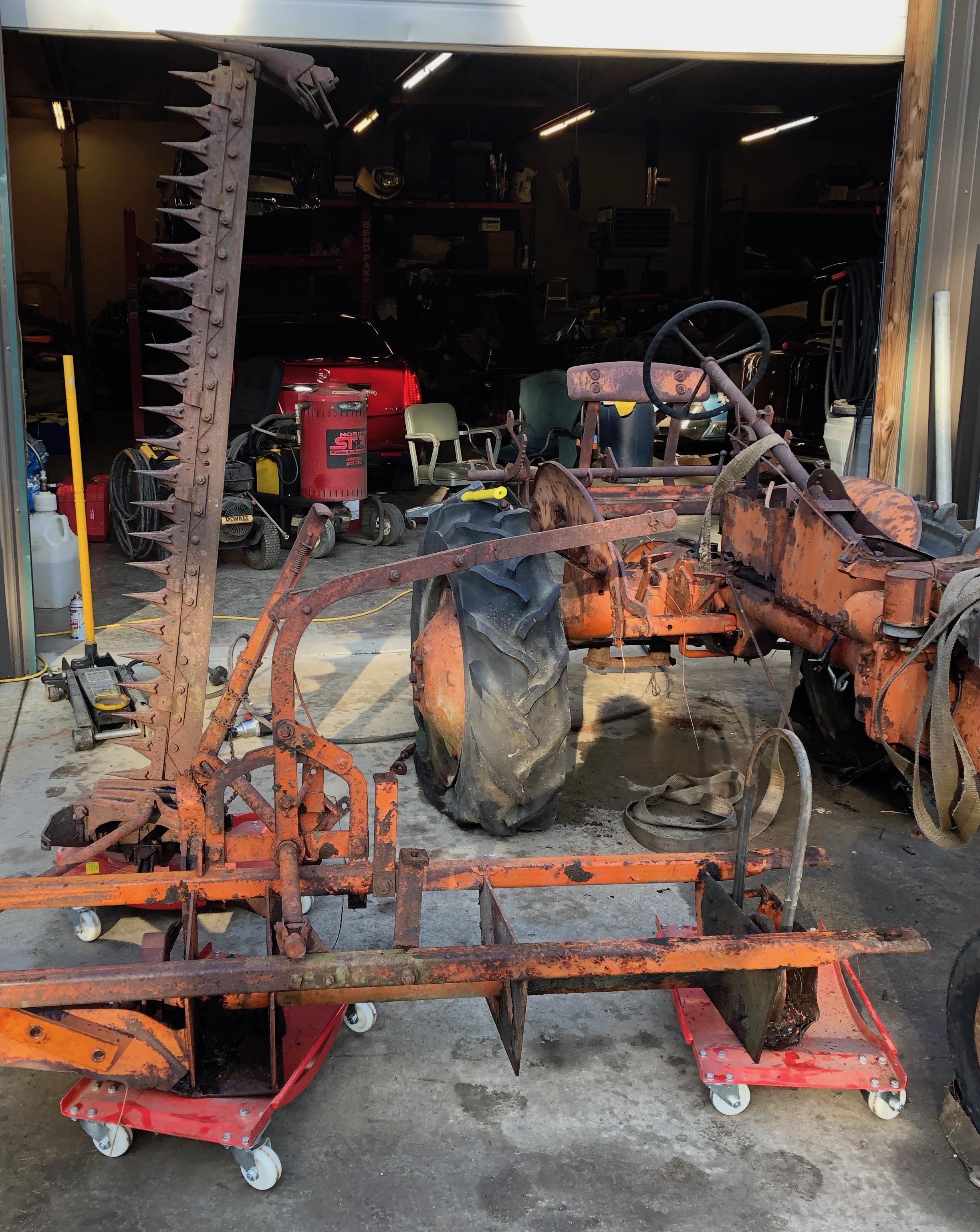

Here are pictures at the start of the process.  First removing the sickle mower.
As I start to break it apart
Yes it is a rusty bucket.  I have used a lot of elbow grease, heat, and BK blaster to get it apart:)
