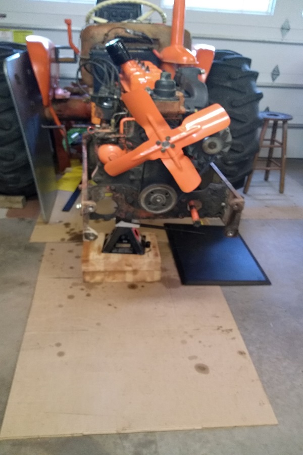

Post Options Post Options   Thanks (0) Thanks(0)   Quote ACinSC Quote  Post ReplyReply Direct Link To This Post Posted: 25 Jul 2020 at 11:47am
Fav son posted a pic for me . Dunno why it's kinda fuzzy . Got the front end rolled out of the way fairly easy . Thanks to Dr Allis . Also wedged a couple short 2 by 4's on top of the axle under the nose/chin center piece . Thanks Jay .
