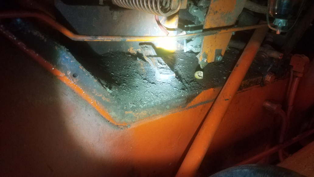

Took off the Left side cover to re-connect a wire and found this lever.  Its just to the rear of the bell housing.  I seems to only go forward 1 "Click"  and back to the rear 1 "Click".
Didn't try it with the motor running as I have no Idea what it may or may not do.
Thanks

Belt pulley lever

that is the belt pulley engagement lever.  All the guts are in the torque tube, if you wanted to add a belt pulley you just need the drive housing and pulley itself. The shift rod would hook to that and come out on the lower right corner of the dash

Got it - That makes sense from the small plug in the dash.
