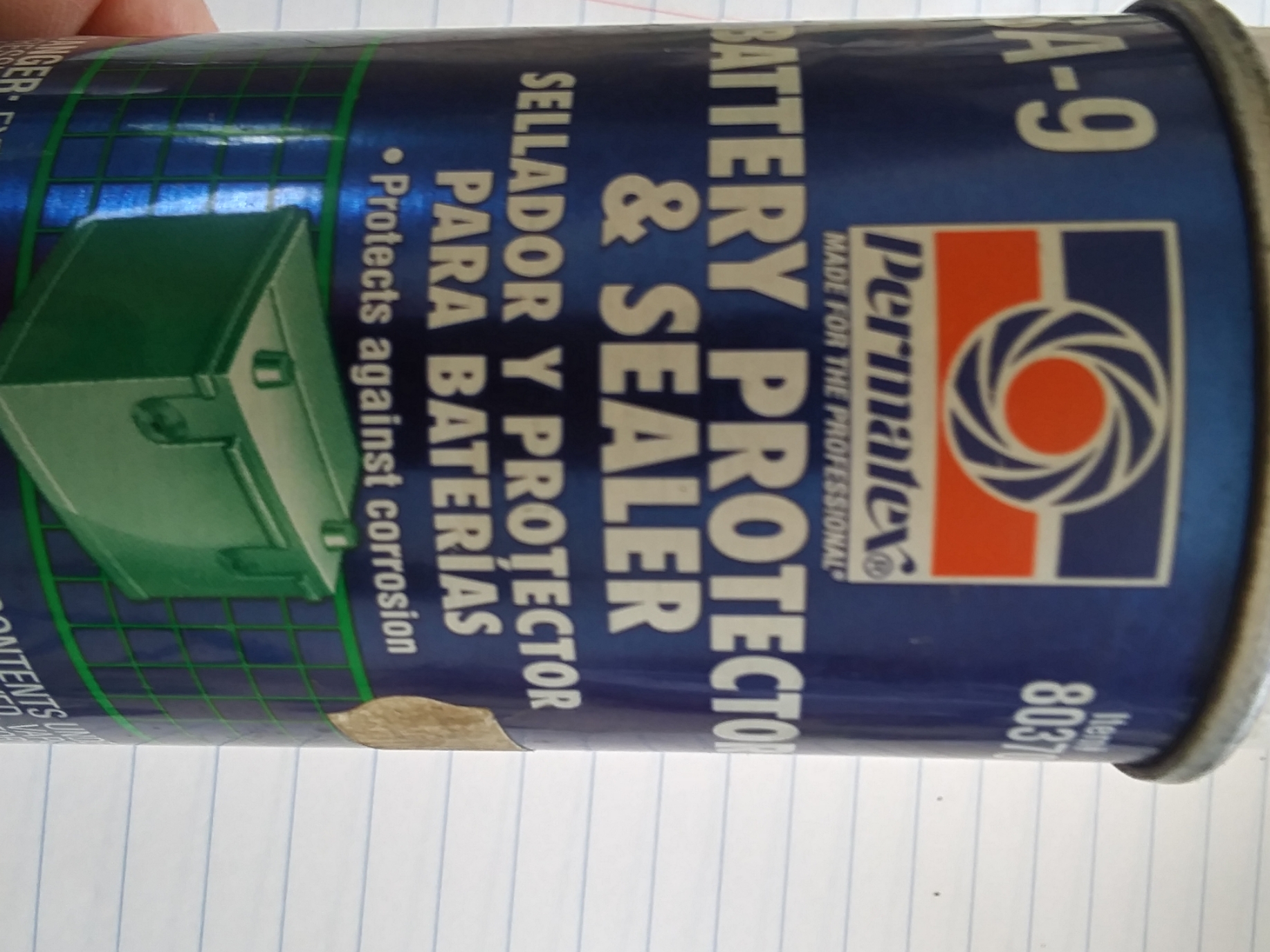

I bought a spray can of stuff that comes out purple and tacky that's a terminal protectant. I can't remember the name of it off hand. But yeah, the key is to keep the air off it. 6V systems are more finicky to the resistance caused by poor connections than 12V, so cleaning becomes all the more frequent and necessary.

Post Options Post Options   Thanks (0) Thanks(0)   Quote AMDG Quote  Post ReplyReply Direct Link To This Post Posted: 12 Jun 2020 at 11:38am
Works well...

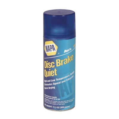

Post Options Post Options   Thanks (0) Thanks(0)   Quote ac45dave Quote  Post ReplyReply Direct Link To This Post Posted: 12 Jun 2020 at 9:08pm
Believe it or not this is what I have used for many years.Mac disc brake quiet, part # MAC 1064 from napa.It looks and smells like the old Permatex red high tack gasket sealer that I used for this purpose for years before.I use it on all my batteries 6 and 12 volt, works great!!

Post Options Post Options   Thanks (0) Thanks(0)   Quote BigGuy1000 Quote  Post ReplyReply Direct Link To This Post Posted: 14 Jun 2020 at 5:34pm
I use Battery Terminal Protector spray can from Napa or Carquest or Farm&Fleet after cleaning the cable ends, bolts, etc well.  Get the correct flat 10 inch braided ground cable with a new bolt at clean ground to tractor at left rear of battery  box.  Connect short round fat cable from the starter switch to - side of battery also.  The flat cable terminal will not fit down on the + terminal properly until you open it up just a little with a large screwdriver on top of a vise.  Get the felt battery washers and put them on first, red or large hole on +, green to - .  The clamp on the - terminal will need to be tightened lots till closed well to get it tight on the battery terminal.  When everything is tight, spray the tops of the terminals and also the sides, so that some spray gets under the sides and ends of the clamps.
My 1951 WD(6V positive ground) used to have this same problem, after doing as above it has not had any problems with terminals for many years!
