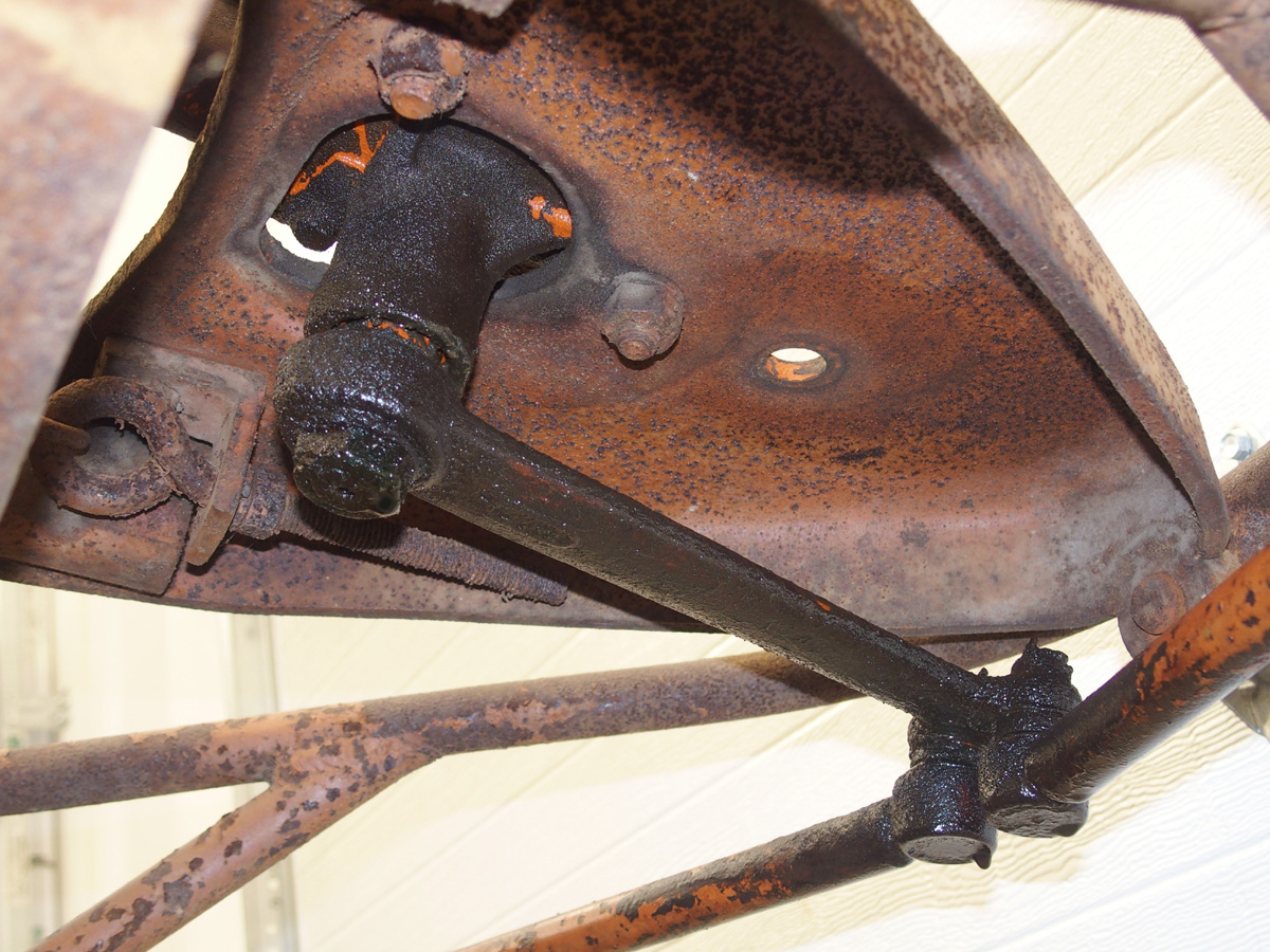

I think my seal is truly shot (see below) HA!

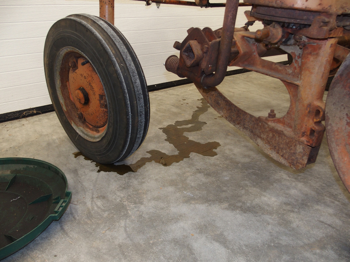

Came out to the do something else in my shop building the other day and saw this.
I had filled the Steering Box with 90W Gear Oil 7 years ago. Over the past couple of months I had noticed a couple of small oil spots under the tractor but hadn't investigated further.

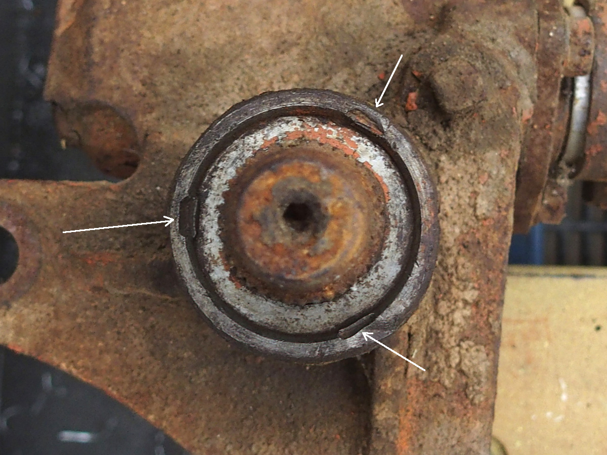

I had a spare Steering Box among my "spare parts" pile and looked at it to see what would be involved with replacing the bad seal. As you mentioned, there are "stakes" (white arrows) around the seal of the spare Steering Box.
So I think I'd like to replace the seal on this tractor but I was hoping maybe someone else had done the procedure. I think the Model B uses the same Steering Box.
I'm wondering if it would be possible to replace the seal without removing the Steering Box from the tractor.
