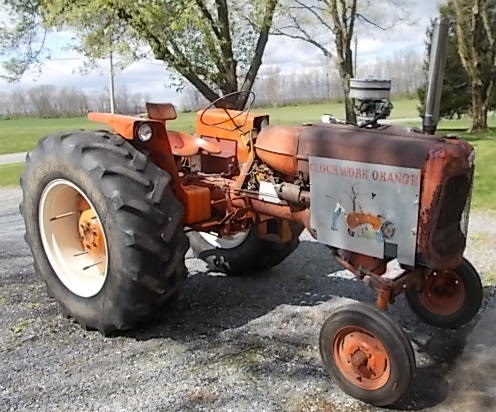

Just use a "deep Dish" steering wheel from something like an I-40 or 190 ect. That what I did on my D10 puller.

I have a G steering wheel for the G, it good use a new covering.
Maybe it could made to be like the one on PaulB's D-10 that he posted a picture of.
