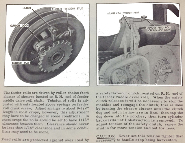

Does anyone have a chart or adjustment guide for the crop rolls located at the top end of the feeder house just ahead of the cylinder on the All Crop SP100 combine ? These crop rolls are adjustable and spring tensioned, one of the rolls is steel the other is rubber coated.  I have read where they should be set at 1/16" gap at a minimum but I have not seen a guide on how to set them up for wheat or soybeans etc. Any help would be most welcome.

I've never seen any more info about the rollers. As long as the clutch is not slipping you should be good.
