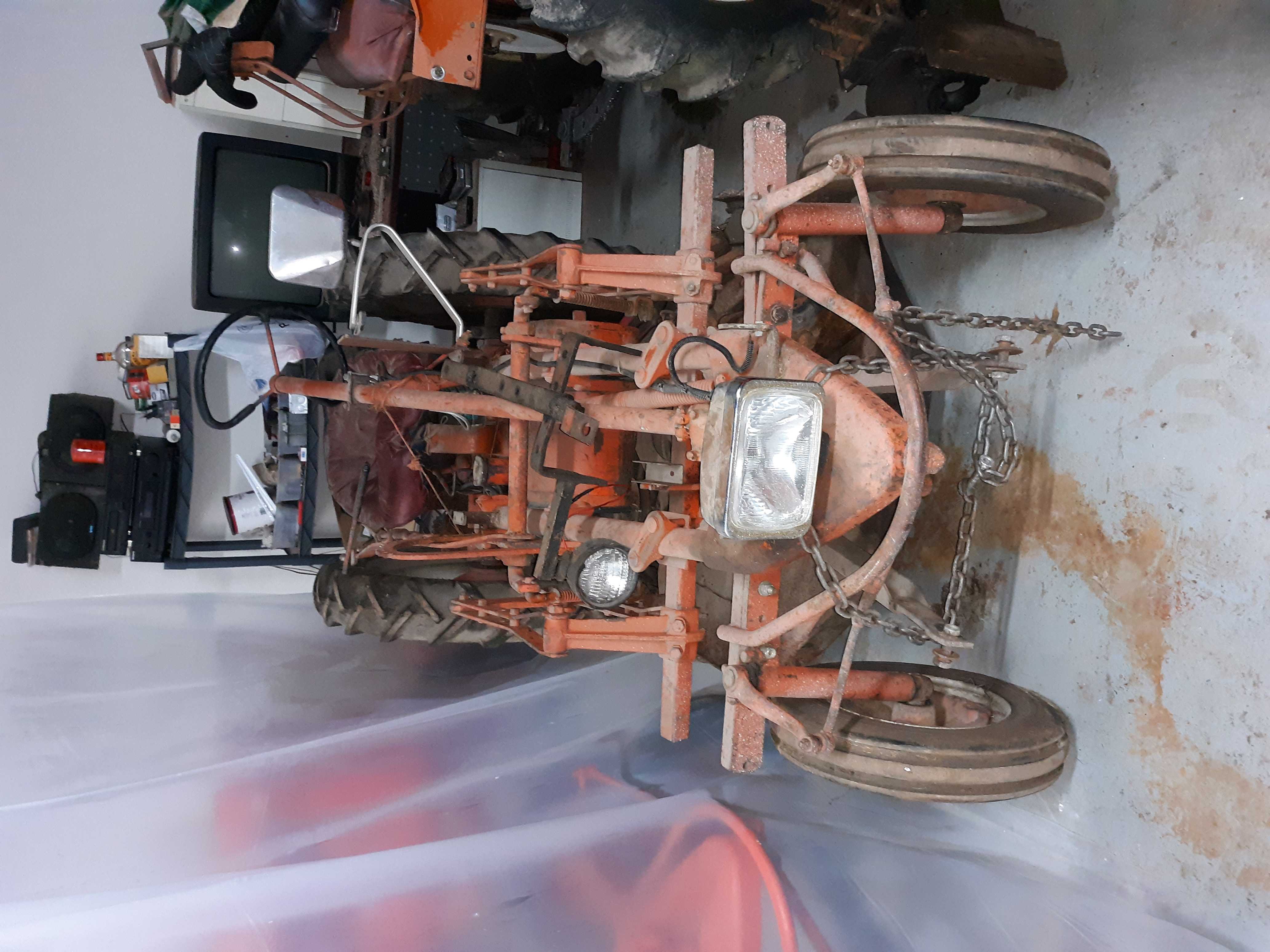

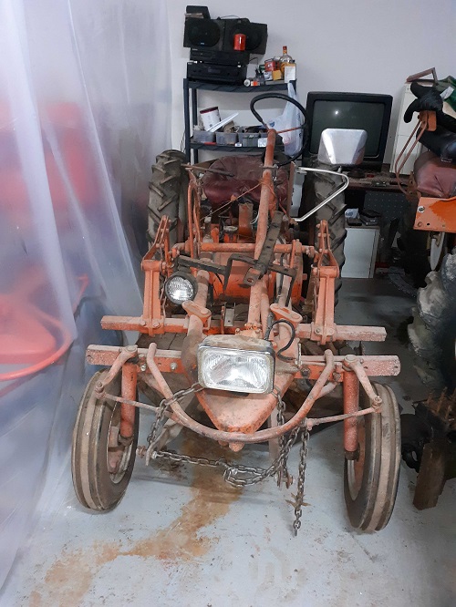

I bought a partial g last weekend. It has a narrow rear end. Does anyone know if the g came from the factory with a narrow rear end? Or was this a mod done later?

I will get a picture of it. I would really like to change it back to original. Would anyone be willing to trade axles or rolling chassis with me? Iij want to mow with it and I'm worried about stability on hilly ground.

The G did have two different length axle housings from the factory. The shorter version had a much lower amount manufactured. Still quite a few out there.

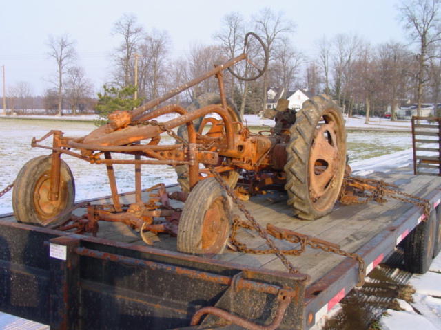

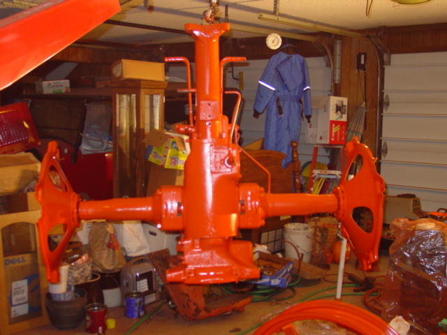

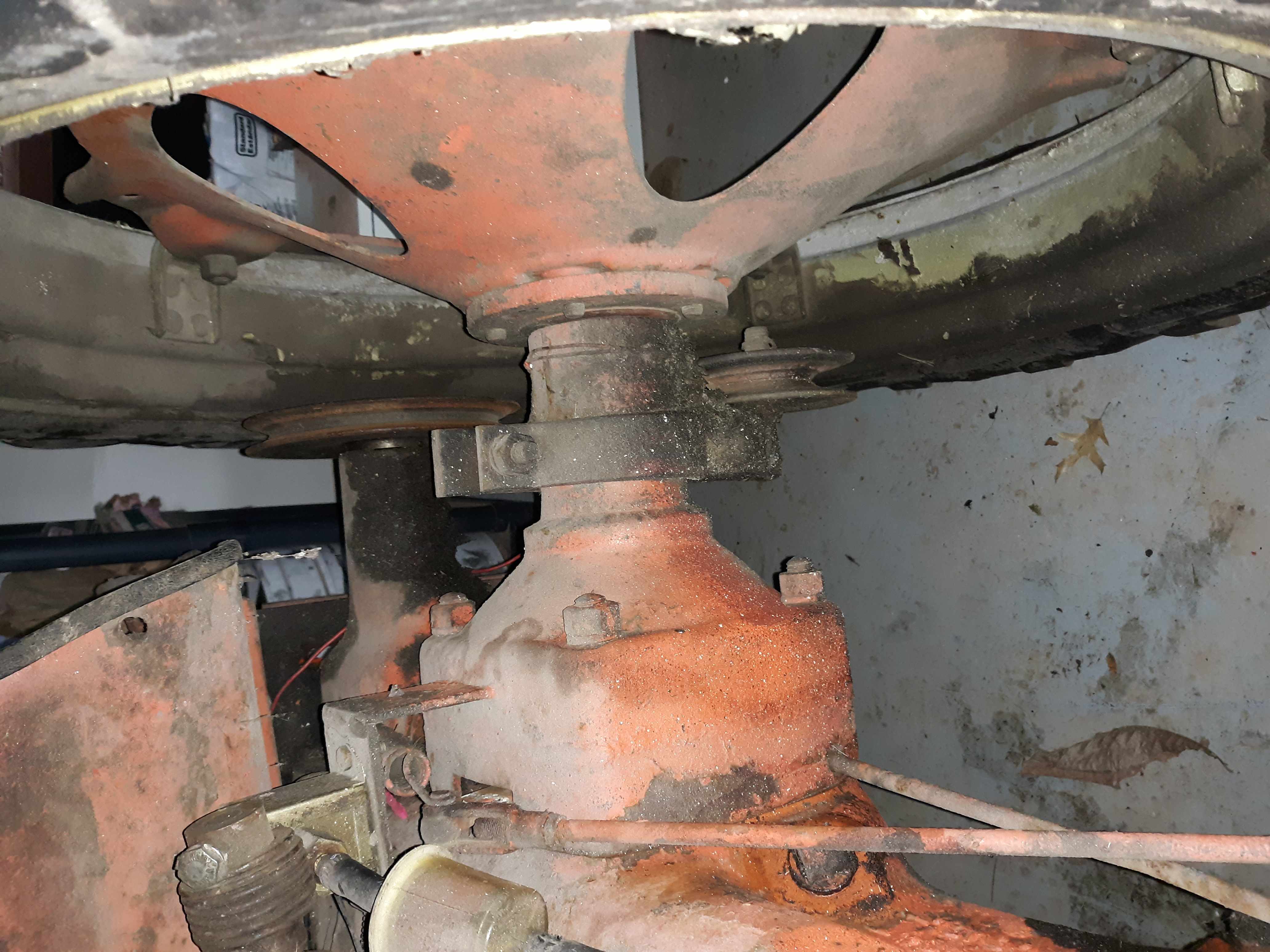

That appears to be a standard rear end. I have a 2nd g like that. I have been tracking down the parts I need. That's no easy task.

I put the pictures on so you could see the differences in the length of your shorter axle housings and my longer ones. I didn't know that you had one to compare yourself. Yours are like all the short factory axle housing I have seen.

I have one tore down that I will never get at making whole again that I would take offers on.

Do you have any pics of the g? Is it complete? How much would you want for it?
