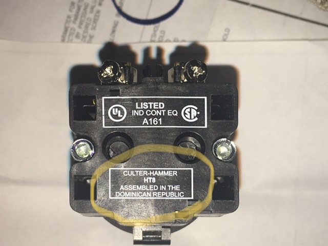

whats wrong with the QC ?

Cutler Hammer, not Culter

Tons of counterfeit stuff comes out if China and ends up in eBay and even Amazon (AMZ has a third party network where people can sell kind of like eBay and often you don’t know the difference)
My Company got hit with about $25 million of fake goods in the marketplace and it took a careful study of the packaging to see that it was fake. You can’t be too careful!
The fact that they misspelled the name (may be intentional due to avoiding trademark lawsuits) says probably fake.

also says UL listed............ I would send a note to CH and get their opinion..

That (the first one) is an asian counterfeit of the proper part.
Many years ago, one of my clients (a DOD contractor) sold some parts to a company in California, and about six months later, they found another company, elsewhere in the US, selling identical parts, under my client's brand listing, but for a much lower price.  My client purchased some, and upon investigation, found that the counterfeiter copied the product, and even used a serial number series, but failed to incorporate matching date-code encryption.  As a result, my client was able to not only determine for-certain which ones were real, and which were counterfeit, the authorities were able to follow the path of acquisition back through the importer, to the manufacturer, to the original buyer, and a whole bunch of people are still in federal prison for a variety of things...
Be vigilant... the house that burns down as a result of this kind of thing, may be your own...

Note that the location of the 2 Labels are reversed.
Also the bottom of the Counterfeit is different.
