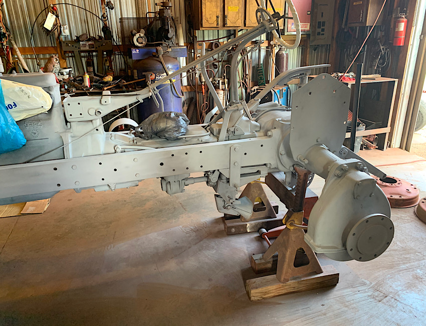

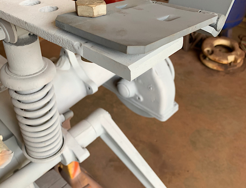

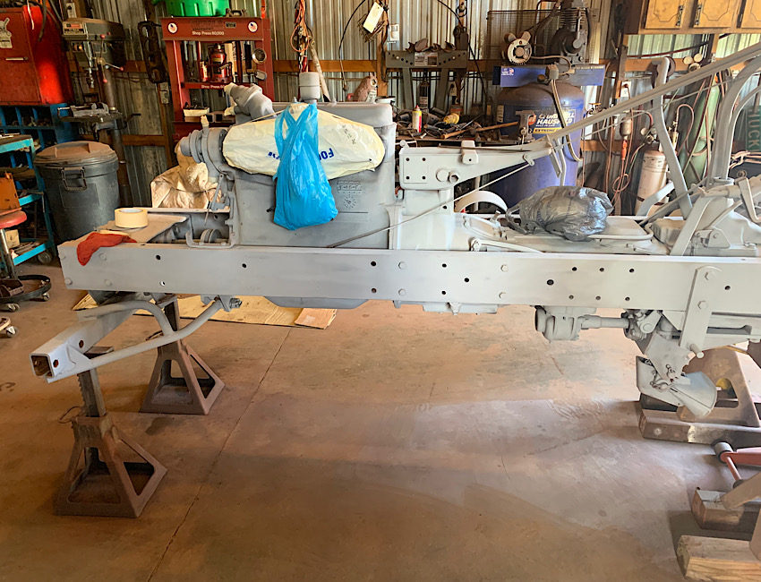

Got it finished stripped as far as it needed to and the primer on...cheated on not pulling the manifold and carb but it was all new and just put on so I wrapped it after spraying them in heat black.

Chris and I discussed making a seat adapter but I actually found one pretty reasonable but dad decided he wanted set a tad further back so I drilled another hole in the perch and weld an extension to the back to match the end of the bracket.

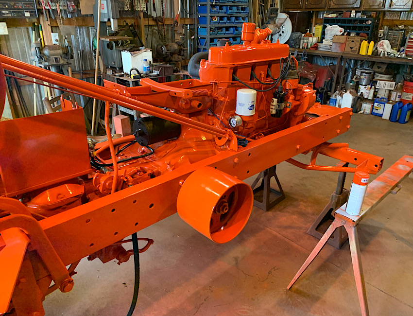

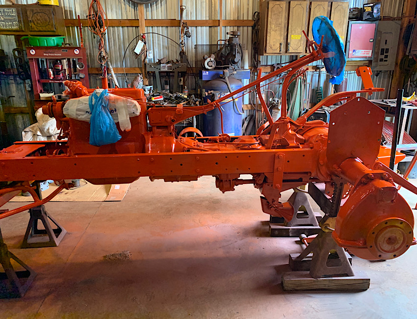

Got the PPG laid on Tuesday.
MDWilliams338 View Drop Down
Joined: 19 Nov 2018
Location: NC
Points: 476
Post Options Post Options   Thanks (0) Thanks(0)   Quote MDWilliams338 Quote  Post ReplyReply Direct Link To This Post Posted: 21 Nov 2019 at 8:54pm

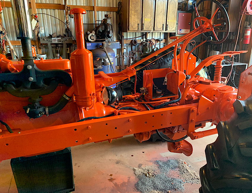

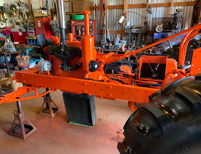

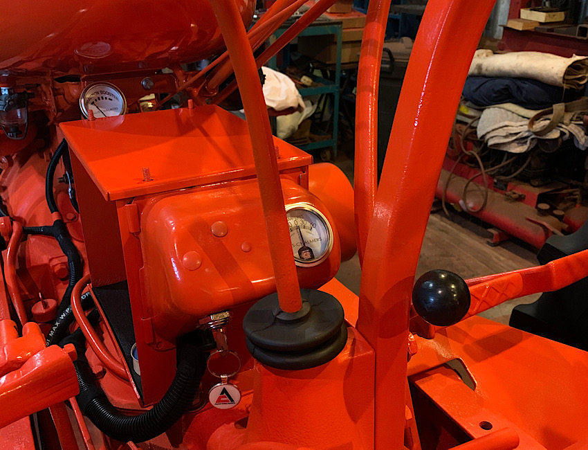

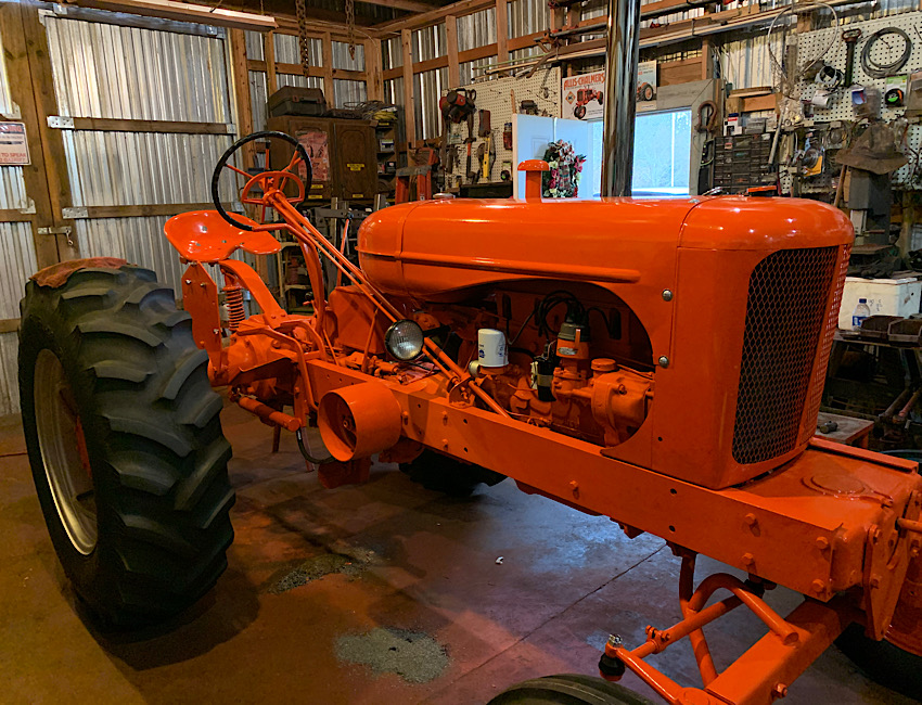

Today I got it wired up,put the lights back on with one of those 25HP exhaust pipes.Got the spindles welded up where they were scared,turned back down and put back in the front axle ,just not bolted up yet.

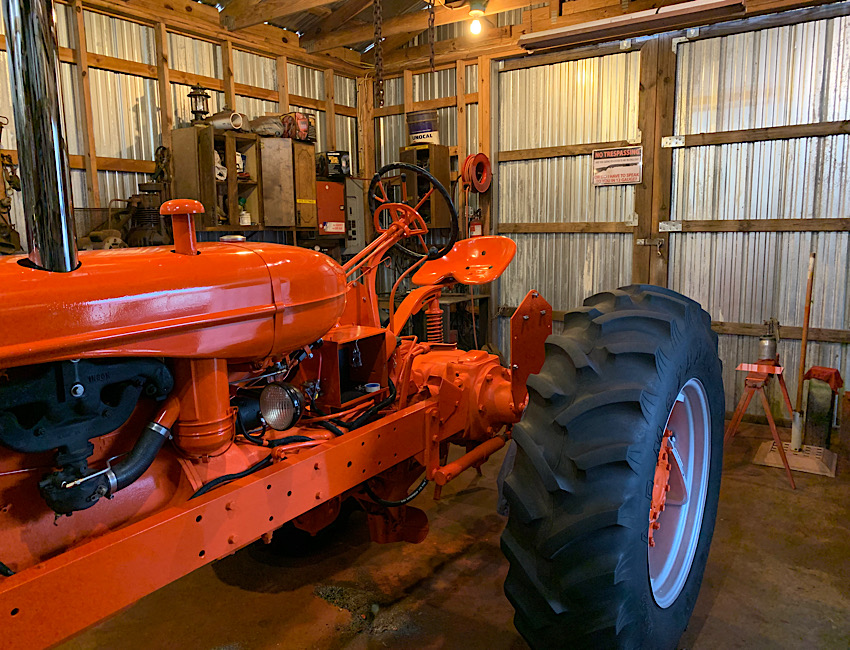

My goodness it's purty. Whatcha gonna do with it. Brush hog some brush with it?
Points: 90510
Post Options Post Options   Thanks (0) Thanks(0)   Quote steve(ill) Quote  Post ReplyReply Direct Link To This Post Posted: 21 Nov 2019 at 9:11pm
Very nice work........ Great heavy duty jack stands... good plan !

Post Options Post Options   Thanks (0) Thanks(0)   Quote MDWilliams338 Quote  Post ReplyReply Direct Link To This Post Posted: 21 Nov 2019 at 9:15pm
Thankya sir! I think dad said he wanted to use this for his Halloween and Christmas hay wagon puller.
Joined: 19 Nov 2018
Location: NC
Points: 476
Post Options Post Options   Thanks (0) Thanks(0)   Quote MDWilliams338 Quote  Post ReplyReply Direct Link To This Post Posted: 21 Nov 2019 at 9:18pm
Thanks Steve ....be glad to get the front wheel wheels on too and get this bad boy off the stands and on its feet.

My favorite AC tractor is the WD45,    yours looks great !!   NICE job.

Looks like a $$ Million!! Nice work.  I NEED a set of jack stands like those......

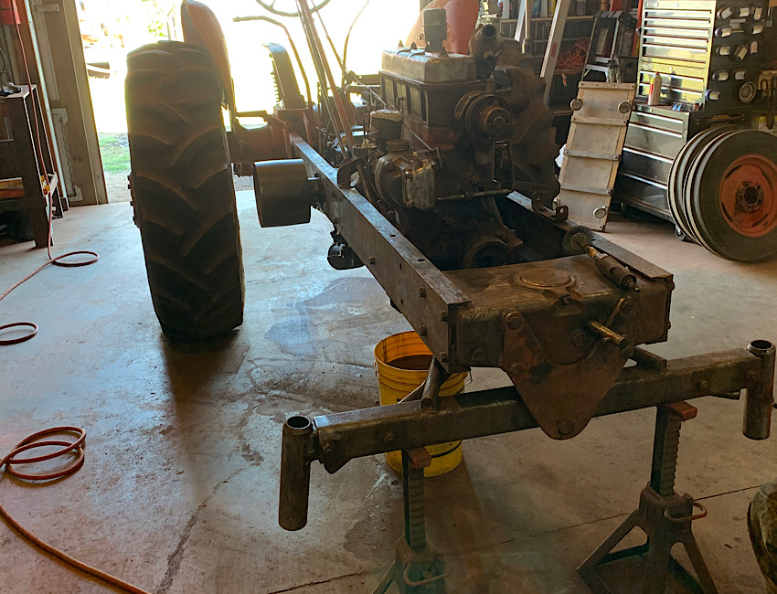

That's coming right along and looking good!
When I redid the front end on my 45 I considered welding up the spindles but not being sure of the material opted for new ones. Did you have any trouble with hard spots?
Points: 8647
Post Options Post Options   Thanks (0) Thanks(0)   Quote Sugarmaker Quote  Post ReplyReply Direct Link To This Post Posted: 22 Nov 2019 at 8:28am

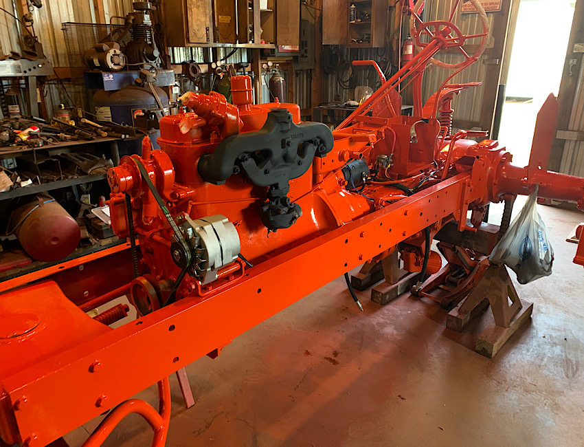

Mike,

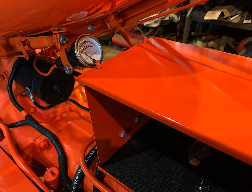

Thanks for taking the time to post these progress pictures! You make it look easy, but I know some of the moves and you have to keep right after it! Tell your Dad and Mom Hi for me!
I was trying to figure out what that pin was on the outside lower left fender bracket. Now I see thats where you hang your lunch!:)
Alternator looks like a nice clean installation and I see it has been converted to key start with solenoid. Looks like a good position for service.
Your weather is way better than ours as your doors are open on your shop!
The exhaust and carb look fresh with the high temp black.
 I see a spray can of orange, just for touch up? What paints did you use? Color look very good!
Seat flipper and extension is a nice touch. Your dad and I are about the same size and maybe age too and a little more room to get on is not a bad thing!
How are you doing on the sheet metal, hood, rad, tank and fenders? These alwasy consume mass quanities of my time. Of course most of mine are in need of much attention!
How hard was it to get the adjustable front axles out? Most of ours are rusted tight!
Great job! You know I think that is the part of the work that I like the most. Getting it back together and fresh paint! After that its hard to keep them looking that good. What are the rear tires? You have them shined up good!
Its going to look real good hauling that Christmas wagon!
Mike ,these actually weren’t too bad in terms of the actual scarring and hard spots.Put a little heat in them with the torch,TIGed the spots and being they were fairly small I ground them down with the hand grinder and finished on the belt sander.I’ve done two sets like this but I’ve had a few sets that I just took to my machinist that were too far gone that I didn’t have the time to work on.I’m actually better at grinding than welding...my dad used to build trailers for years and my main job was to grind welds and corners smooth.....and to be in a hurry to let go of the ground clamp when he’d say “ move the clamp,ain’t got no ground” OUCH!!!😂

Mike,
Hey Chris,I’ll for sure tell them. Yeah I actually had some food in the bag and clear skateboard deck tape for the foot rests and rear step/pto cover.Typically the weather in NC won’t get too stable until about Christmas,until then Mother Nature is a confused mess with a few good days here and there.The spray cans are used for a couple of touch ups and dad sprayed this oil old tank in the background next to the building.But honestly after we’re done assembling I can spend an hour or more with my secret sauce of International orange I get from our local hobby shop (I know but it’s practically an exact match) model enamel paint and a fine model brush touching up bolts and other dad mishaps😂.I used PPG 60080 this time ,what we had left from the D17 and I think I used SW on my sons B.The radiator dad just got back from the shop cleaning it out,leak checked and they did their usual heat black on it(sitting under the tractor) and the axles weren’t too bad.Left side came right out and the right was a little snug but I slid a 1” steel rod in from the empty side and it came out with some finessing.The rears are 14.9 Armstrong’s that we’re on it ,they’re in too good of shape to pull off and I think he’s going with 6.50 on the front ,not sure which flavor yet though.Going to try and get most of not all of the sheet metal next week if Mother Nature plays nice,so we’ll see.
Now that I’m looking at it I had to hit the inside of the axle tube that I forgot after I finished spraying and cleaned up everything,that’s just how it goes for me sometimes 😂

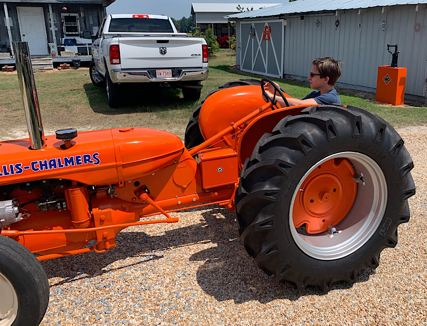

 Your son looks like the coolest kid in school with the sunglasses and that awesome low slung B! I had forgot about that one! It sure is cute!

Yeah man,he had a blast driving this in our town founders day parade and what was funny all the hotrodders had all their cars parked when we rolled in and as soon as the tractors came in to park most of them flocked to come check it out.If he could get away with it he’d drive it to school.But not a whole lot done on it today other than getting the spindles in place and bolted.My parents are taking off in the morning to GA to look at a D14 I believe and I’ve got to work all weekend making tires so it’ll be next week before we do any more to it.We run Stabil in all our stuff...it doesn’t seem to take long for fuel to set before it’ll make gas engines act up.

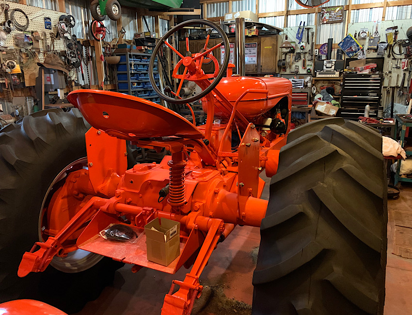

Post Options Post Options   Thanks (0) Thanks(0)   Quote MDWilliams338 Quote  Post ReplyReply Direct Link To This Post Posted: 11 Dec 2019 at 9:12pm

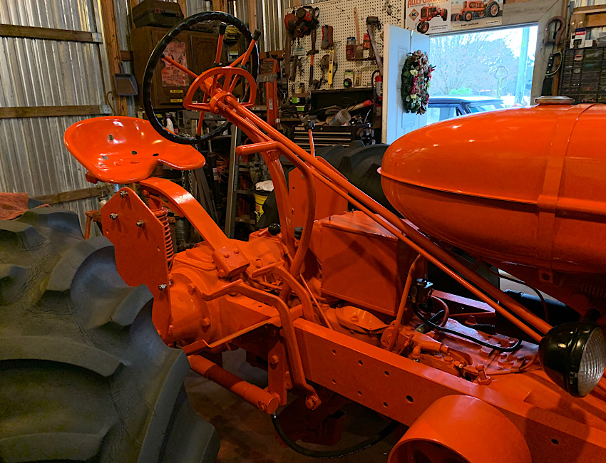

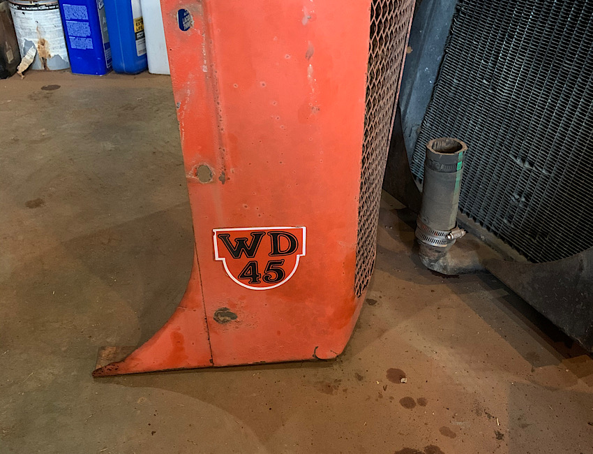

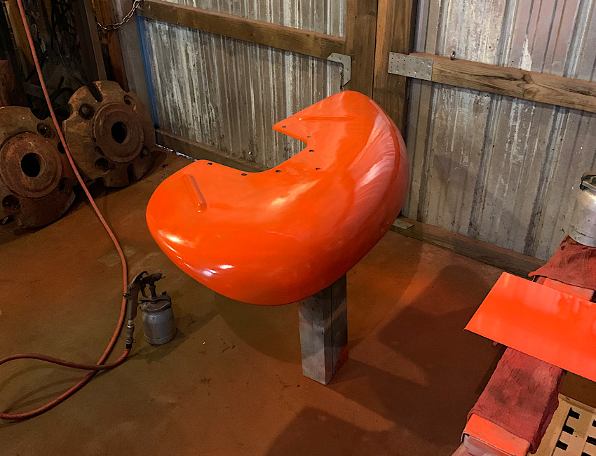

Well in between the rains and work I got the nose cone,hood,tank,batt side panel and one fender (almost done) before I ran completely out Orange PPG...just my luck but oh well will try again this weekend.
Joined: 19 Nov 2018
Location: NC
Points: 476
Post Options Post Options   Thanks (0) Thanks(0)   Quote MDWilliams338 Quote  Post ReplyReply Direct Link To This Post Posted: 11 Dec 2019 at 9:20pm

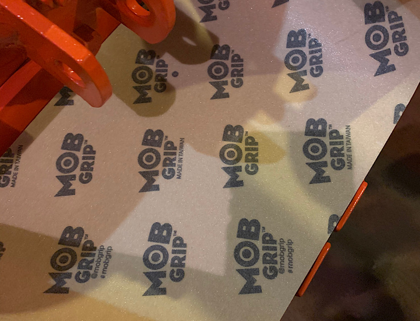

My dad wanted the usual black grip tape on the back but I’ve never been fond of putting black tape on such a pretty shade of orange so as I was going to get more tape from Lowe’s my son informs me I can get clear deck tape all day long from the skate shop in town so went and got some to try out and I think I like the clear better...just have to find my roller to press out the remaining air.

Post Options Post Options   Thanks (0) Thanks(0)   Quote Dave(inMA) Quote  Post ReplyReply Direct Link To This Post Posted: 11 Dec 2019 at 9:26pm
MD, that looks GORGEOUS! But a question: what is grip tape and what's it used for? Thanks!

Post Options Post Options   Thanks (0) Thanks(0)   Quote MDWilliams338 Quote  Post ReplyReply Direct Link To This Post Posted: 11 Dec 2019 at 9:54pm
Dave,thankya sir! Well my dad likes to be sure footed when climbing on and off these early AC’s that can be a little tricky to maneuver ...and to keep his big ol boots from scuffing the paint.I’ve got to put some on the foot rests also.
