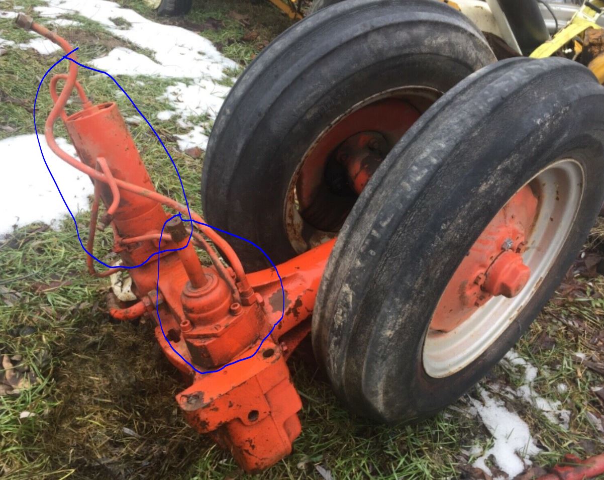

Guys,
Seen this NF for sale...notice the circled parts...are those specific to NF or are they the same for WF? In other words if I got a NF, would those have to be included?  I think not but want to be sure....thanks
john(MI) View Drop Down
Location: SE MI
Points: 9262
Post Options Post Options   Thanks (0) Thanks(0)   Quote john(MI) Quote  Post ReplyReply Direct Link To This Post Posted: 14 Nov 2019 at 8:29am
Appears to be the power steering components that are circled.  On the D14 those would be on a power steering bolster, but not on a manual steering one.  I'm not sure if those parts can be installed on a manual one.  The pump is not show and would be needed for it to work.
Those parts would not be needed  to be included, but you sure would enjoy driving the tractor if they were!

Thanks....was wondering if perhaps those PS parts would be slightly different, say like the mounting holes for instance as compared to same parts on a WF.

If you have a wide front with power steering you only need the narrow front pedestal.
The rest is the same.

On my d17 they appear to be the same on the wide front axle also.

Should all fit both wide and narrow fronts

Thanks fellas for the confirmation.

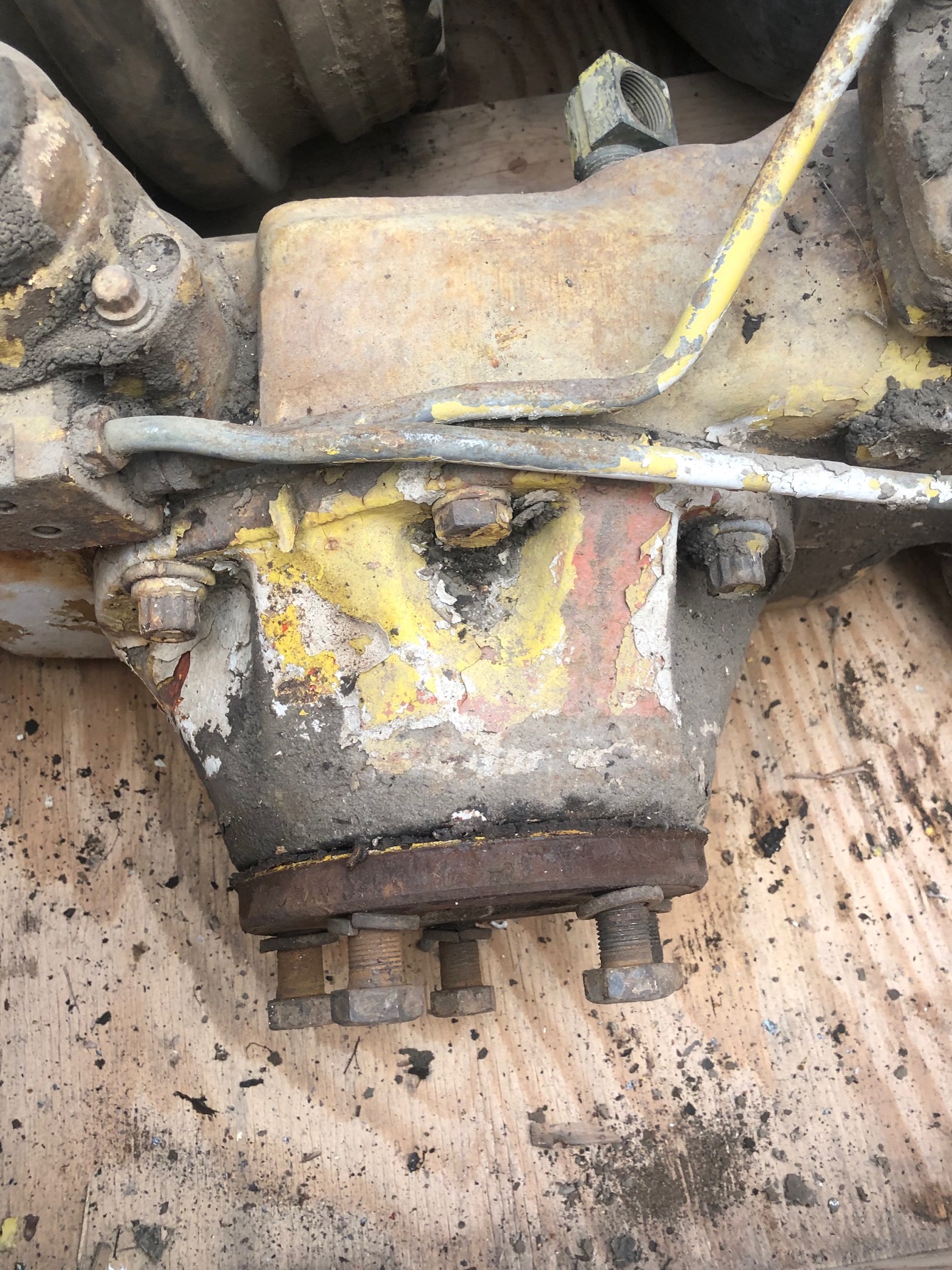

Post Options Post Options   Thanks (0) Thanks(0)   Quote Calvin Schmidt Quote  Post ReplyReply Direct Link To This Post Posted: 17 Nov 2019 at 12:22pm
Bearing holder attached to the main steering block from a D-15 Single front

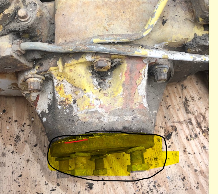

Calvin,
You talking about the highlighted part?
Calvin Schmidt View Drop Down
Location: Ontario Can.
Points: 4556
Post Options Post Options   Thanks (0) Thanks(0)   Quote Calvin Schmidt Quote  Post ReplyReply Direct Link To This Post Posted: 17 Nov 2019 at 7:30pm
The complete casting up to the bolts shown. About 6" tall. The flange you have highlighted is where the single front fork bolts on.
