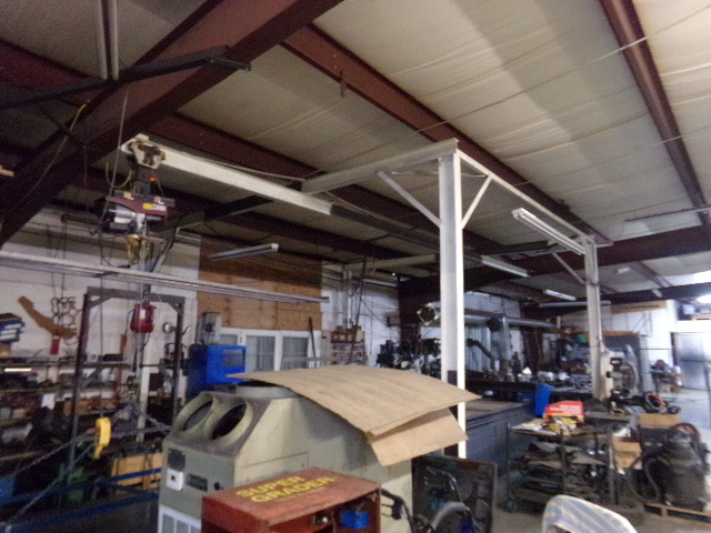

Post Options Post Options   Thanks (1) Thanks(1)   Quote cabinhollow Quote  Post ReplyReply Direct Link To This Post Posted: 30 Oct 2019 at 12:18pm
Here is my overhead crane. 30' long
It is setup to load 5'x10' sheets on to my plasma table.

I pour my own crete, and when doing the outer 6 foot areas where tool boxes and work tables and other tools/storage will be along the walls I placed 2 inch 4x8 sheets of foam board under the concrete. I mix fiberglass in the crete while mixing it. frost will travel up to 4 ft inside under the outside walls in cold climates. there is about 2 inches of crete over the foam boards, with the fiberglass in it, it has never cracked yet, been there 20 plus years. the floor don't need to be as thick as the shop space/work area to just hold up tool boxes and such. do what ever makes you happy! at the time, I couldn't afford heating tubes in the floor, but now if I need to lay on the floor, I lay on old carpet I salvaged from a dumpster in town. (no pet stains) and when it gets dirty/oily, I throw it in the burn pile.
Points: 35679
Post Options Post Options   Thanks (1) Thanks(1)   Quote DMiller Quote  Post ReplyReply Direct Link To This Post Posted: 01 Nov 2019 at 6:20am
Came to the Conclusion a 40x60 MIGHT not be big enough after considerations. If deal any with Trailers of any length a 50 x 80 with END doors(Pull thru) and 16' interior height is a Necessity, then set side doors and Heated section workshop(s) to one or two corners. I try to separate wood working and metal shops so do not dust metal shaping tools and no metal slivers impaled onto wood, also lessens fire chances some.

Post Options Post Options   Thanks (1) Thanks(1)   Quote LeonR2013 Quote  Post ReplyReply Direct Link To This Post Posted: 02 Nov 2019 at 3:40pm
There is no question that you need heavy plastic under you floor. I've done it for years and haven't had a failure yet. It is a must.     Leon
