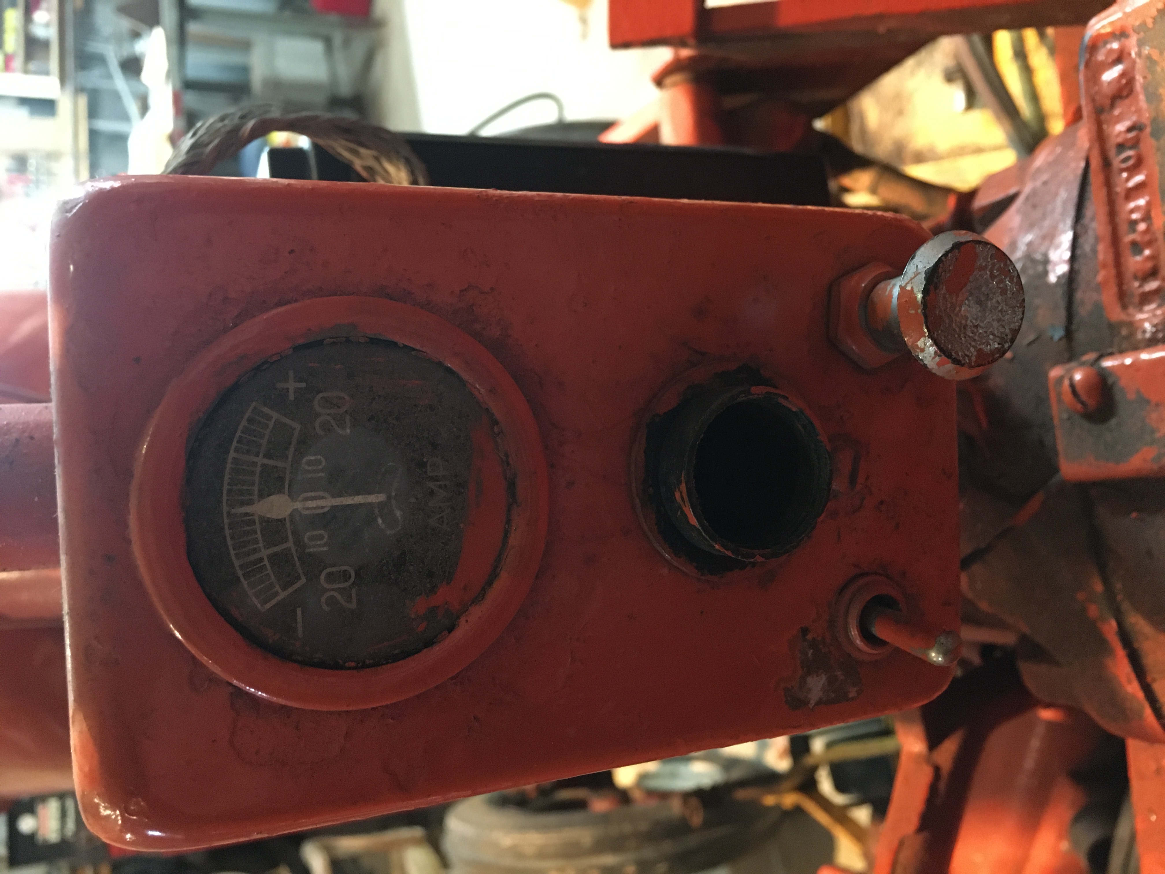

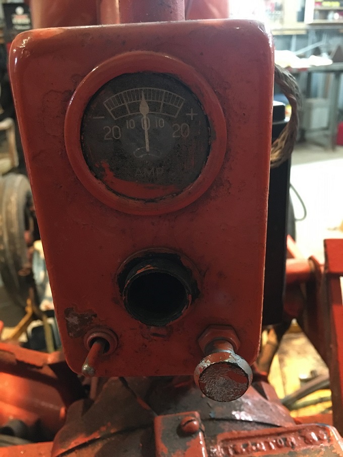

I’m trying to get my “new” b started. It was stored outdoors the last year or so. The engine turns freely and it has a new 12v battery. The lights work but I have no spark at the plugs. The instrument cluster is different than shown in the manual. It has a push / pull switch on the lower right for lights. A three position toggle switch on the lower left of which only two poles have wires, one to a ground and one to the magneto. Whatever was in the middle is missing. Can I bypass this switch somehow to see if that is my problem?

A mag should either have a tab to ground it out on the side of the mag or a wire going back to a switch to ground it. Make sure the tab is clear of the mag body if it has a tab. In your case unhook the wire from the mag and that will bypass a shorted to ground wire as well as the switch.

You posted you have a wire to the mag from a switch and the switch has another to ground. By saying you disconnected the kill tab to you mean the wire connected at the kill tab and a kill tab?
As for the switch missing something in the middle it might be that is just the switch someone had available and only used those two posts when they wired it. You can use an ohmmeter or other type continuity tester to check continuity between the switch poles if you unhook the wires from it.
