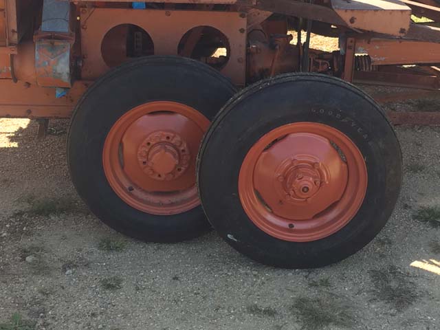

I’m trying to get mine mounted. Does anyone have any pictures of it on a 60 or 66?

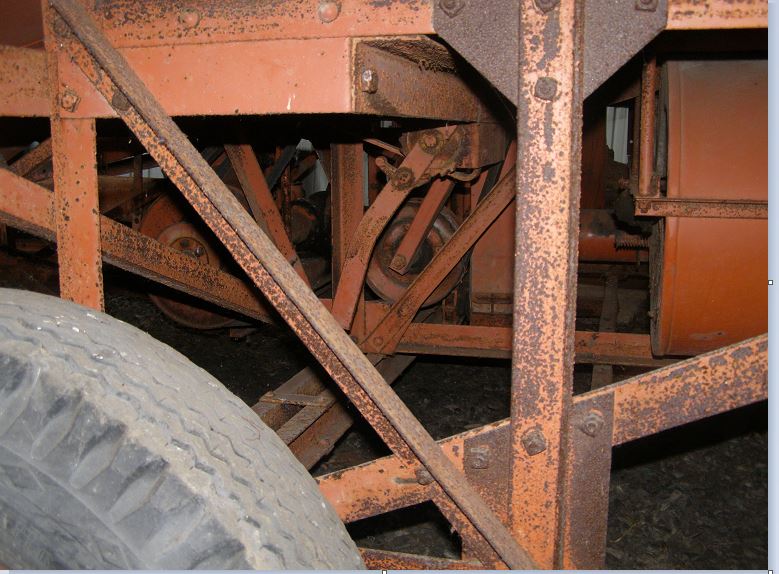

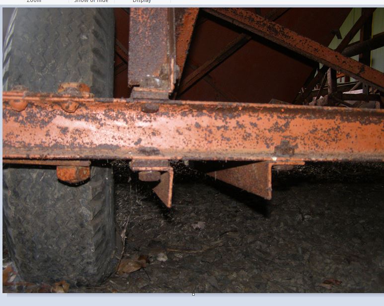

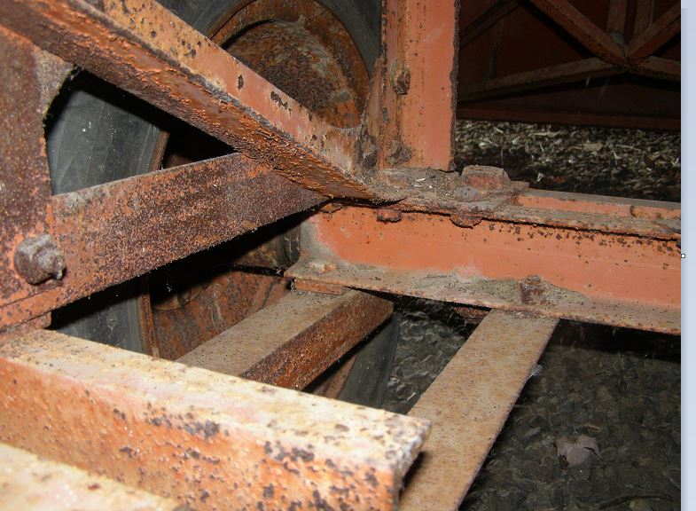

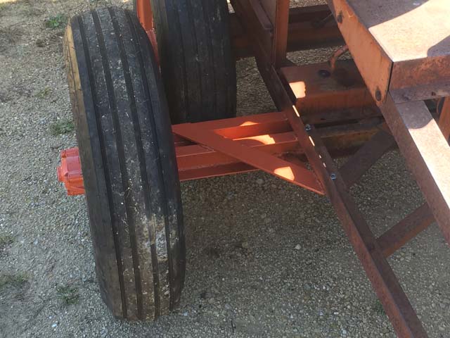

Here ya go. hope this helps

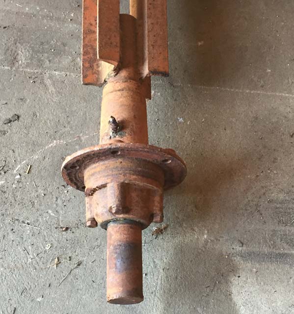

I'll need to post a few pictures of mine. It's a different setup than the one Tom posted.

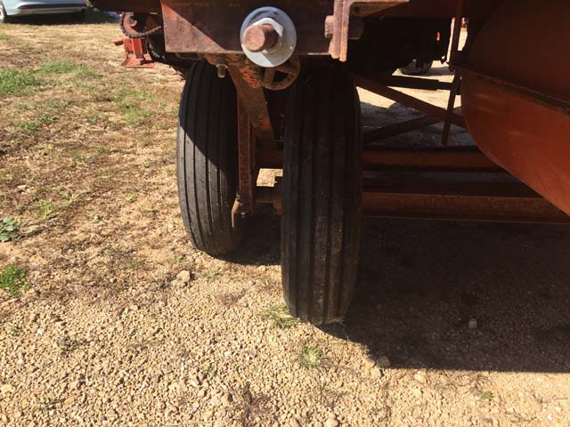

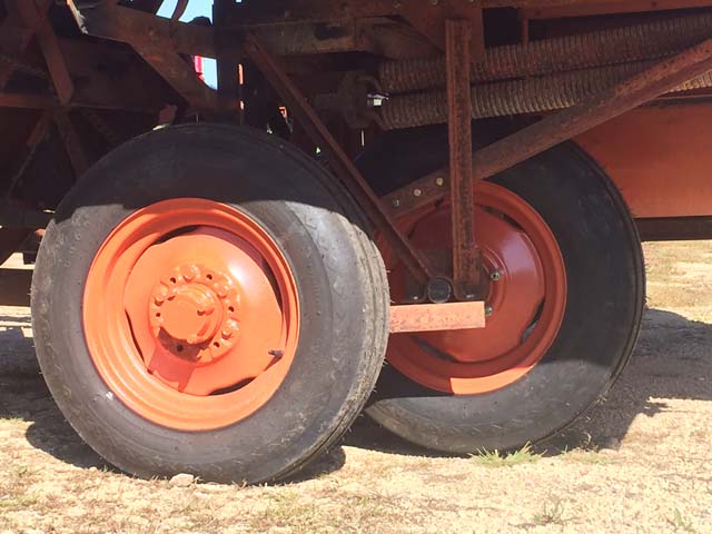

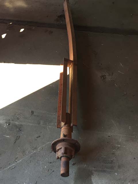

Here is what I have. Not sure if it is Allis or an aftermarket, but sure looks like an Allis. Maybe early design?

Never saw one like that....

Me either! Especially with that stub sticking out.

Well, here it is all mounted up!

Looks pretty neat!

Nice. Does look like a cleaner design than OEM.  Wonder if this was aftermarket..

The only down side with this design is that you must remove the axle assy. to repair or change the tire.

I mounted the tandems on the All-Crop that has the two row corn head. So the up side to this design is that the left side tandem wheel runs in the center of the row. The Allis or Common design would put the wheel right on the row.
