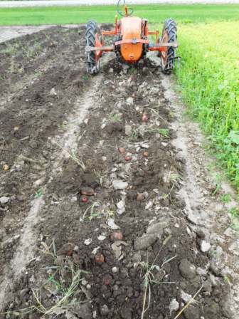

The new potato digger didn't work to bad. If they had been planted before the end of June, been weeded better and dug a little drier probably would have worked better.

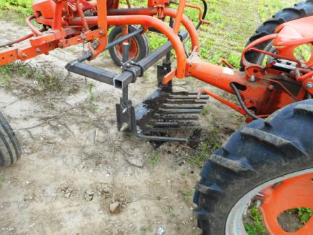

Looks very functional.  Surprised the G had the traction and power.  Two bolts on each side; is the blade tilt adjustable?  Herb(GA)

Looks good!----You must have sandy soil ! --- In this ground here that would never work! --- I tried something like that only on a cub and didn't get 10 feet with it. --later modified it to pull type and had to pull it with wd-45 and it was a load for it.
I like your design and like you stated, ground needs to be dry and weeds must be kept out. ---No reason yours won't work in a good year.

Yep. Made it with 3 holes, level, 11 degrees and 22 degrees. It seemed to work best at 11 degrees. I don't plant that deep and I hill the taters a lot, so I'm really not going that deep. No sand here. It's very tight loam. If you drive on it wet you're screwed. And I did this year.....could not help it. No problem with traction. It was snorting a bit, but that engine is real tired.
