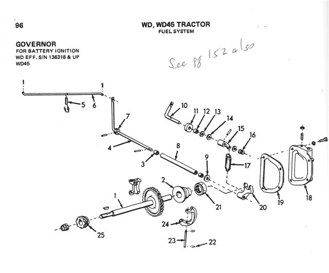

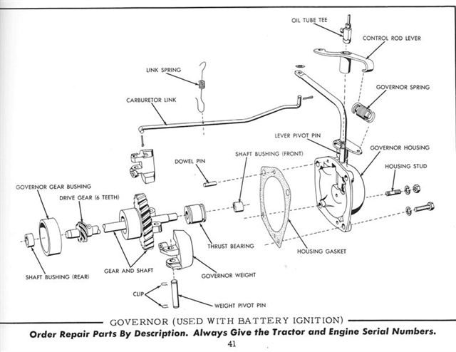

OK,  We've talked about the mysterious carb link spring here a time or two in the past.
Here are a couple of pics taken from two different WD manuals.
The description: SPRING, carburetor link (prior to Engine S/N 244001).
It is sometimes (often) referred to as the "anti-surge" spring.
Believe it or not, it hooks to the draincock, hence the large hook on the one end of the spring.
My '51 WD has the spring.
A similar spring was also used on B and C tractors.
Dick L. says the spring is not necessary on he Bs and Cs if all the governor linkage is adjusted properly.
He is probably right because even Allis discontinued it on the WD at some point.
