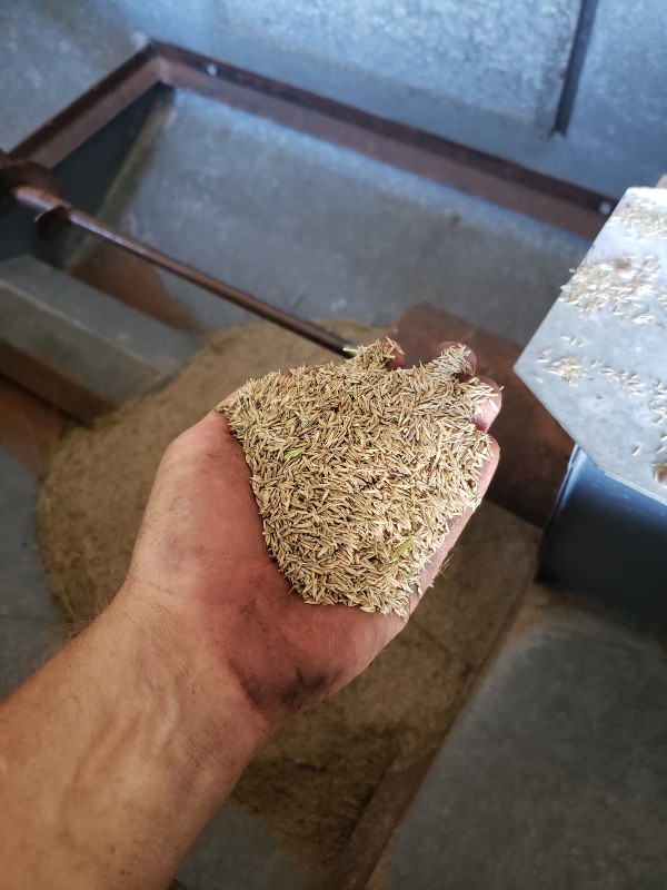

Took my A2 to the field after finishing getting it switched over from beans to fescue. Which is changing the cylinder drive sproket, putting concave bars back in. Found a bearing about to go out. Replaced it. Closed the cieve and shoe down. I was cutting in 1st gear. Dad made me speed up to 2nd gear full variable speed and this was the sample.

I know Bob thought the old man had lost his mind helping him with in-field setting the old AII to cut fescue and then I said to keep speeding up he had to be thinking now the old man is just trying to plug the cylinder. lol
Now all Bob needs to make the job go faster is to find a 16' head (over the 14' he now has on it) so he can get over more ground in a day.  I know Bob was happy to hear the big farmer next door to the field he was cutting said that was a better sample than his much newer John Deere puts in his grain tank. It's nice to see a 50+year old combine work so good!
GOOD JOB Bobby!

Looks like an excellent sample to me .    The  60's all crops where good grass machines also

In my "mind", it just seems bass ackward to clean-up a sample with increased ground speed Geek. 2 seasons ago I posted our dilemma with dirty soy sample in the F2, consensus was to drive faster LOL!!

Combines work best at capacity. Drive faster puts more through it at a constant RPM. At least according to my Stueckle book.

About 40 years ago, I worked one year for a guy who sold certified seed. That sample looks like what we put in the bag after it went through the cleaner. Maybe better.

Its clean for sure! The weather is sure playing he'll with it,, at .65 a lb good money in those sticks

Bobby, Now I am not a good judge, but that sure looks like seed that has been across a fanning mill!
Awesome! Sometimes those old dad's do know a thing or two!
Glad your showing those big green guys a thing or two also!:)
