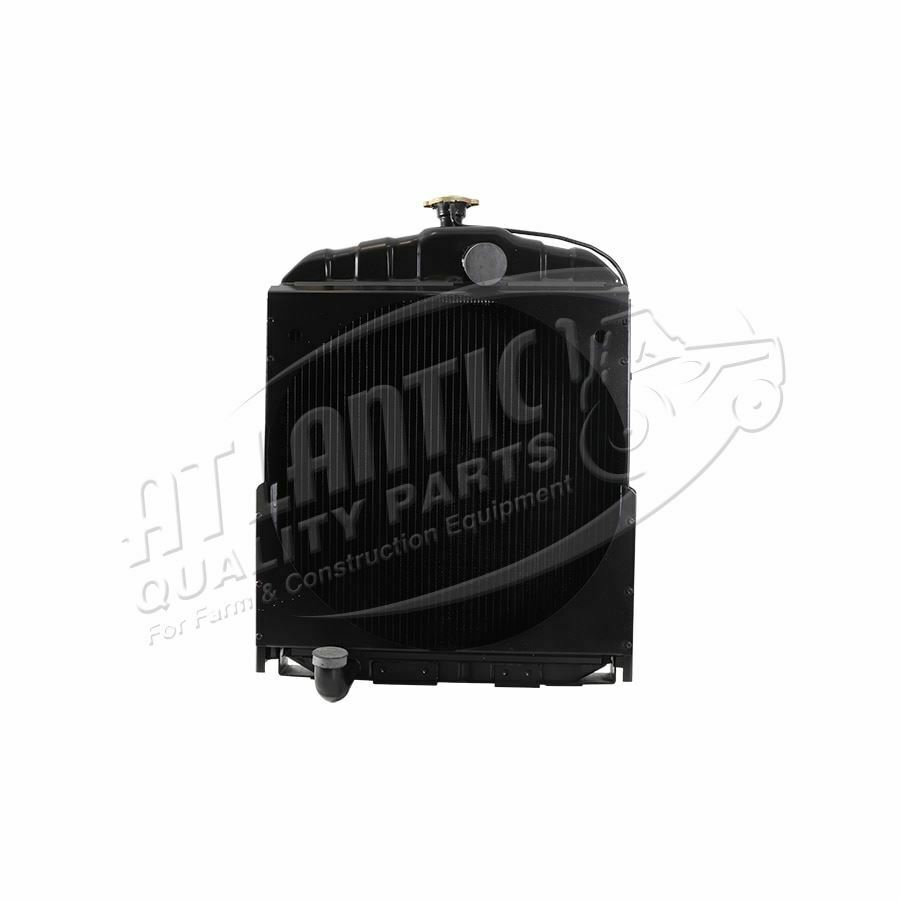

   I was shopping for a radiator for a very early D17 Diesel.  I don't have the proper part number so that is probably the main problem. Anyways the only info I can find that actually lists what model D17 that radiator covers is for Gas and LP. I can't find any stating they fit the diesel, Some listings just don't specify what model D17 the radiator covers.  Another problem related to finding the right radiator I came across, relates to the lower radiator hose for diesel applications, the sellers  state that their diesel hose will only fit D17 diesels s/n38964 and above and mine is 1212 so that's another Delema. As far as the radiators go one common part number sold for D17 is 70229702. This is supposed to be for a Gas/LP only  But what is confusing is some of the pictures for this part number show the lower radiator connection to be on the right and some on the left. My lower is on the left or driver side. Are the gas radiators on the right, and Diesel on the left, is that the difference? On Ebay, for instance, one listing( 264278920518 ) for part number 70229702  shows the lower inlet on the left and then the very next listing for the same part number( 390333249439 ) show it on the right. Here are the two pictures both under the same part number and there are many, many, more examples showing the radiator one way or the other under this part number, uploads/9178/s-l1600.jpg

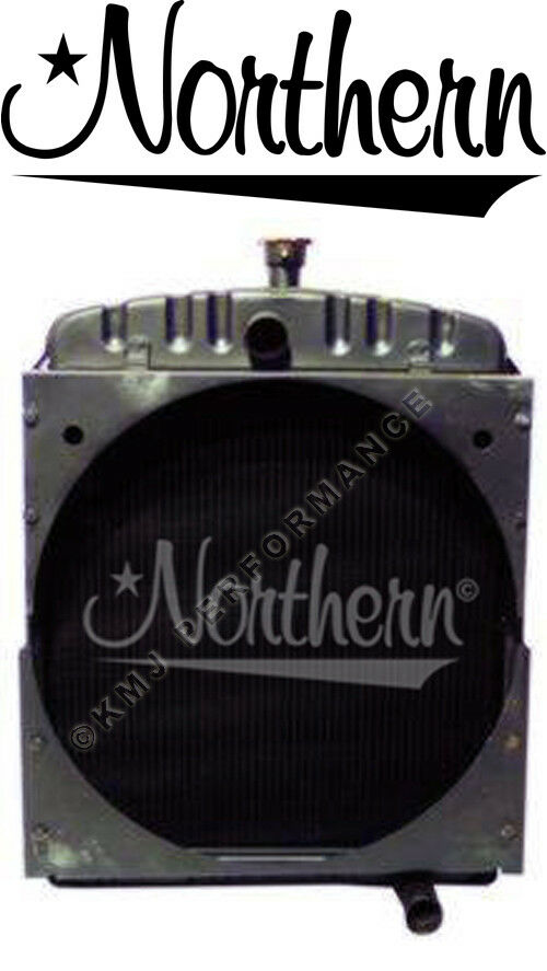

Here is the other picture showing it on the left

Diesel is opposite side of gas.
