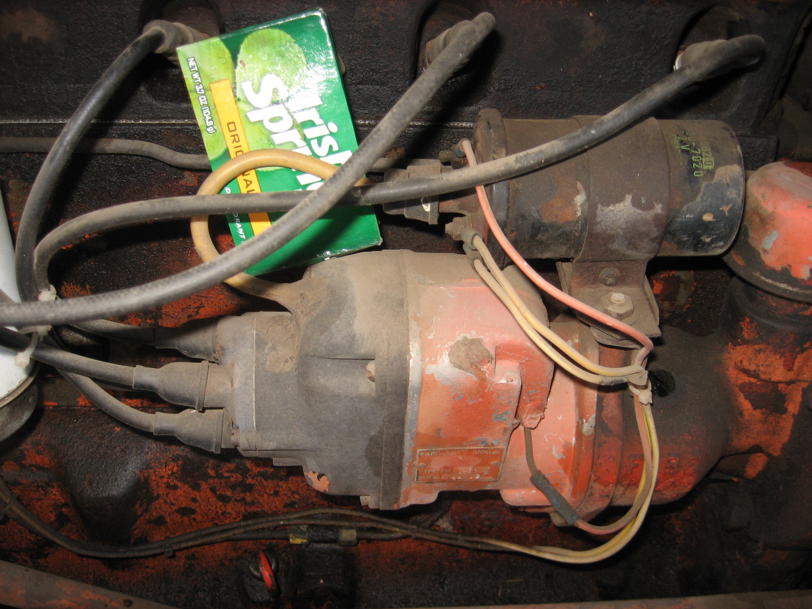

    Can anyone out there tell me what this is about?
     I have a 1937 WC converted to 12 volt with alternator and relay stater.
     I'm guessing someone bored a hole in the cap to install a coil because the one on the mag burned out.
     The present 12 volt coil has an internal ballast and there is also one near the stater motor.
      This seems redundant to me.
      I'd rather have just the magneto like the original.
       The soap is to deter the mice.

Either someone didn't know the coil had an internal resistor or some folks beleive you have to cut the voltage back to 6V to protect the points and will put in multiple resistors

The spark won't be as hot with two resistors. It might work, but it would be borderline. If the battery voltage were pulled down too far while cranking the engine, it may not start. It wasn't uncommon to bypass the resistor during the cranking phase on 12 volt cars that had 6 volt coils. That gave the coil considerable extra snap and gave quicker starts. Two resistors would do the opposite of this.
Unless the mag was burned to toast, it probably could have been repaired. Sometimes the mag coil would burn out, but replacements are still available

People do that, but I’m with you. You just can’t beat a new or properly rebuilt magneto. It’s worth the $, which isn’t too much anyway.

The cost of a Mag depends greatly on what's actually wrong with it. Magneto parts as everyone knows are expensive period. In a lot of cases, when I rebuild a Mag for a customer, I reuse what parts that are still in good shape to save the customer a lot of money. Throwing $450. bucks at a Mag is easy if you start replacing all the old parts with new.
A lot of owners do not have the correct tools to work on Magneto's, or they know nothing about them. The one's that are sorta' mechanically inclined do things like what you have sitting on top of the Mag. It works, but its a bit crude instead of repairing the unit correctly. In this case installing the correct coil back in the unit. That looks to be a "J" series Magneto, so they are popular and there are parts still available for them. I rebuild Magneto's if your interested. There are also a few others on the forum here that rebuild them also. I also offer a Mag to Distributor conversion which replaces the Magneto with a Delco Battery ignition. What's nice about the Distributor is I also offer an electronic ignition as an option if you want to go with that. Being you're already switched over to 12V w/Alternator, the Distributor conversion would be quite easy. My Mag to Distributor conversion comes with rebuilt drive & Distributor, new coil (6V or 12V) points or E.I.(optional) spark plug wires, spark plugs, key switch and wiring. The only thing that doesn't come in the kit is ambition. Instructions also come with the kit...  HTH

Post Options Post Options   Thanks (0) Thanks(0)   Quote Mr.Saliva Quote  Post ReplyReply Direct Link To This Post Posted: 06 May 2019 at 8:23pm
      Steve..
       You are seeing what I got when I bought this WC.I'm new at all of this.
        The 12 volt "conversion" did not work..the alternator did not charge the battery because parts were left out!
        The tractor would only run as long as the charge held out..the reason I got it was the frustration of the
        owner's lack of knowledge to fix it.
        The "shade tree" mag repair might have been his also..,but I doubt it.
