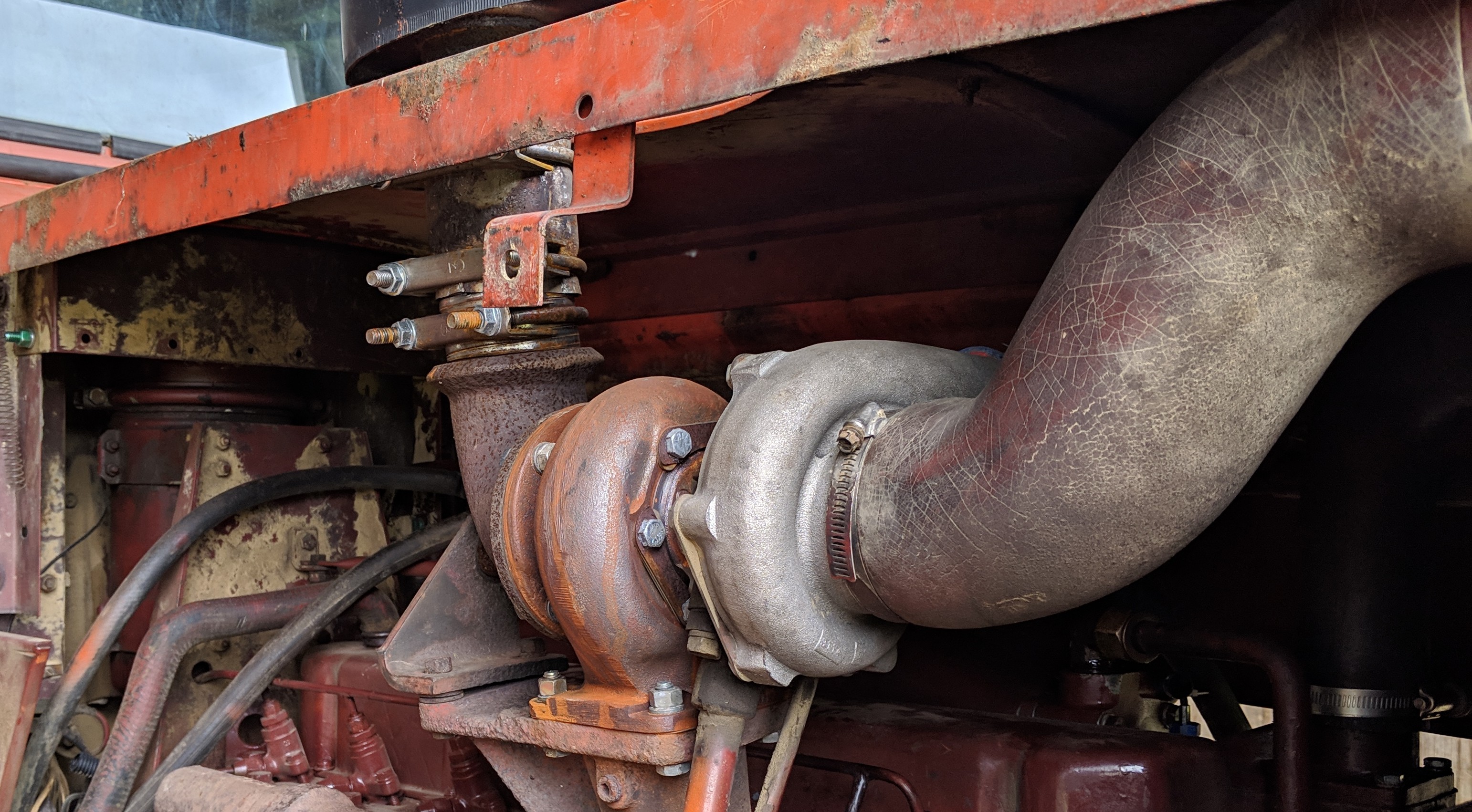

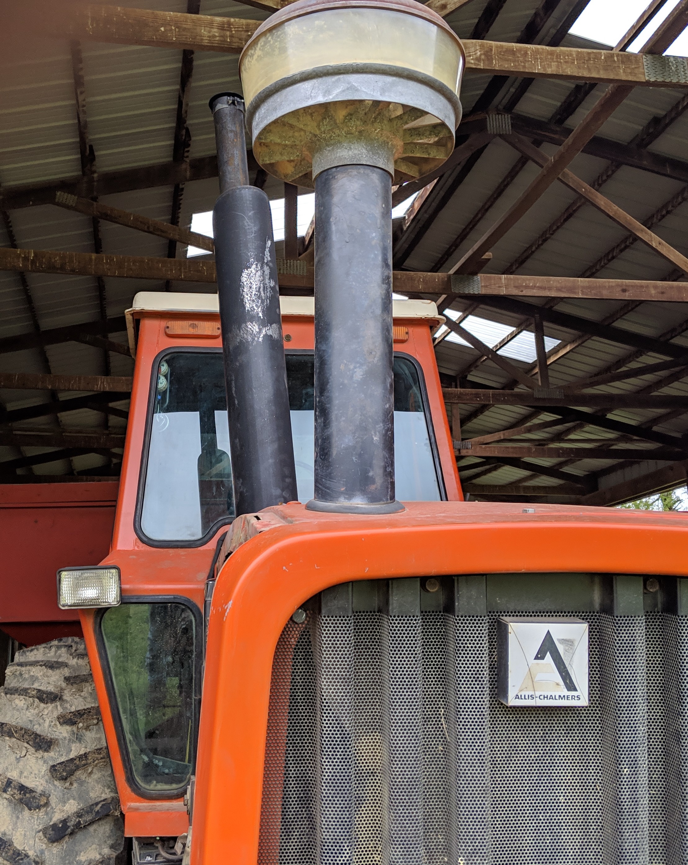

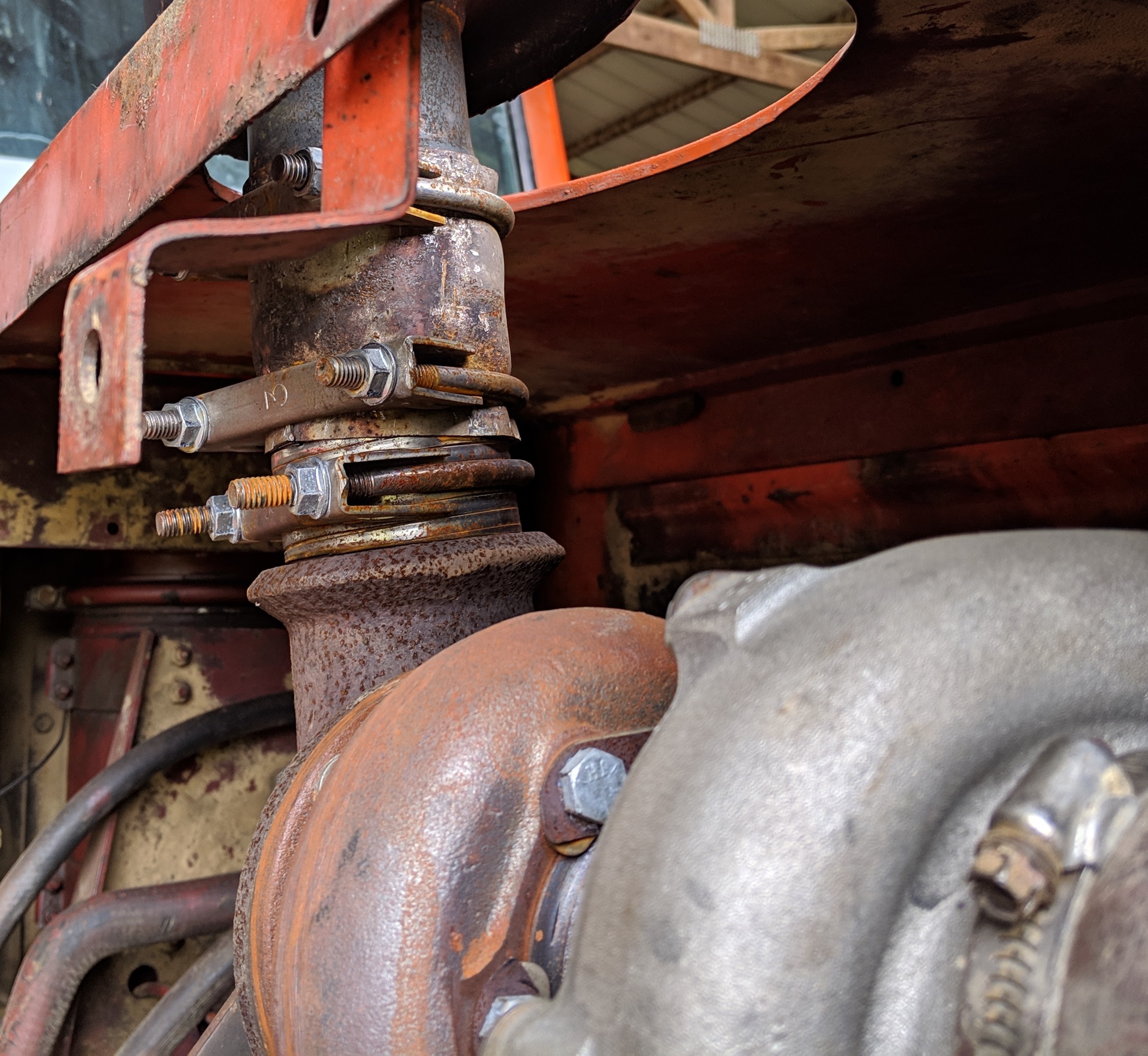

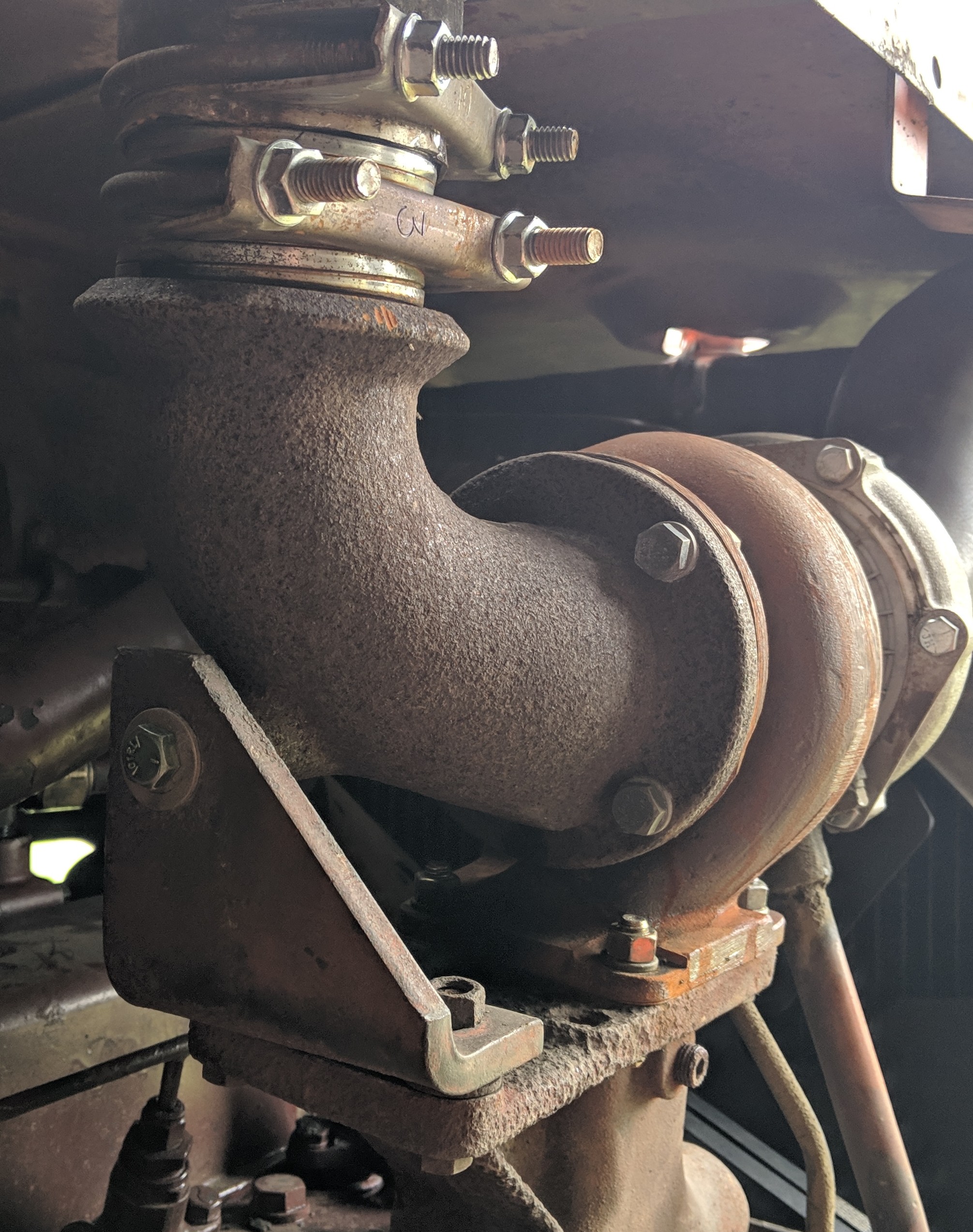

Got a 7060 that ever since I've had it for like 10 years now has had a exhaust pipe that is angled off to the left, making it impossible to fit the factory muffler without using some type of adapter, for years I ran straight pipe but getting tired of the loud noise. It looks like it should to me, I did replace the elbow a few years back but it was the same then as well. Here's a few pics, any ideas? Thanks!

There is something strange about that turbo?

looks like a "center" mount where it should be the "offset" mount? Think the one on my 220 is centered over exhaust port and my 8070 is set off to the side some. Possible? Thinking it is not turbo for that tractor.

That is a non-AGCO replacement part that was made wrong  !!!!     I have seen that before. It should have been taken right back to wherever it was purchased and demanded another correct one or a refund of $$$$$$$.   Your choices are drill 4 more holes to clock it where it should be or buy another one that is correct.

Take the elbo to a machine shop and ask them to slot the holes counter clockwise .375 and you should have enough room to move it straight

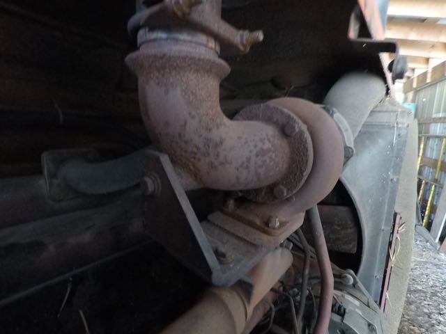

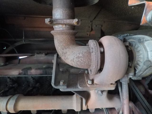

Here's a couple pics of a 7050.
The elbow has an offset.

Thanks for the pics Ron, I'll know how it's supposed to look when I do the repair.
