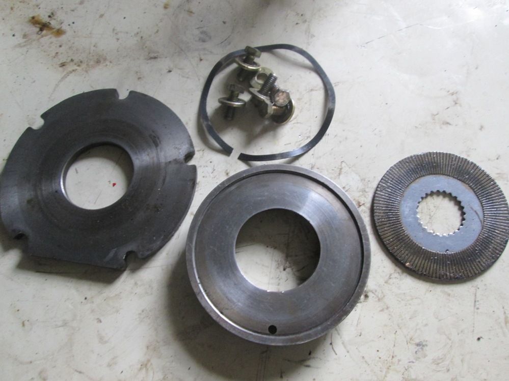

Post Options Post Options   Thanks (0) Thanks(0)   Quote Lynn Marshall Quote  Post ReplyReply Direct Link To This Post Posted: 20 Mar 2019 at 8:02pm
These pieces were out of an 8030. I had the transmission out of that tractor. Long arms help if you are going to do it up through the hole.
