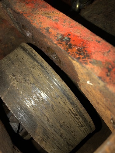

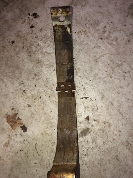

Got into the left side today. I now know why that brake wasn't working very well!
Removed the tire, including the center, then pulled the final drive unit off. [Note to file - next time, drain the rear end before blocking access to the drain plug with dunnage! Ended up draining it through one of the lower final drive stud holes, thereby avoiding dumping oil all over the floor.]
Here are a couple of pictures of what I found. Look closely at the drum, especially the 1/4" or so closest to the housing which is the part of the drum NOT worn by the brake band. Not only is the drum scored but the area scored by the brake band is worn down close to 1/8". The brake band is trash - the hinge was frozen and the lining was broken in a couple of places - more now that I wrestled it out of the housing!
The next step was to try to pull the drum. Hah! No good way to get a wrench in there to loosen the lock nut on the locking bolt. Decided to consult with Don(MO) who advised me to destroy the drum with a good sized bar and a BFH if I can't get the bolt loose. This will give me room to get at the lock nut and bolt. He warned me to be careful to not hit the final drive housing while destroying the drum. I will need to find both tools before proceeding!

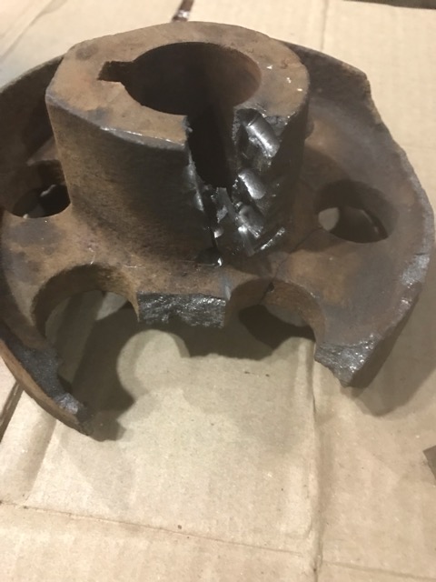

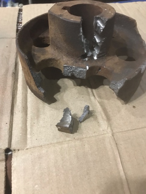

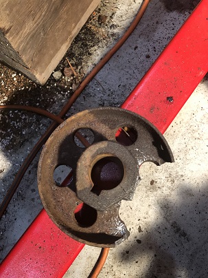

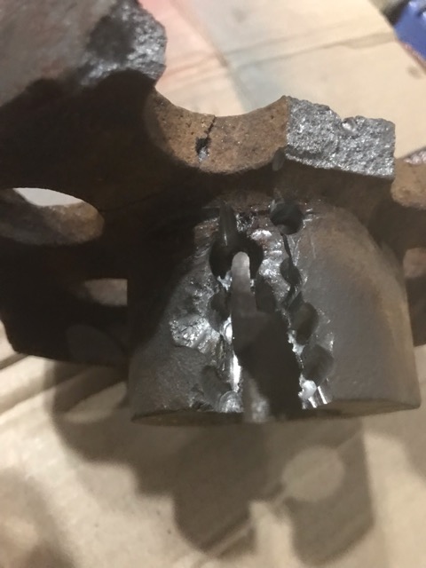

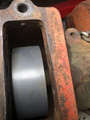

I have won the battle! Old drum is off, new one on. Hug
I created carnage as have others - broke off enough of the drum to give me access to drive it off with an air hammer. Discovered something that made the job a lot easier: the pinion shaft diameter between the drum and the end that engages the differential is smaller than the diameter where the drum sits. So, once it's driven off that section of the shaft, the drum is loose and can be removed with one finger.
I haven't measured the old drum diameter to see how much material had been lost. Will do that tomorrow.
Here are a couple of pictures. First, the old drum out of the housing:
And the new drum in place on the shaft. I used a piece of oak stake (1"x1") to drive it on:
Thanks to all of you who have contributed to this happy outcome!
