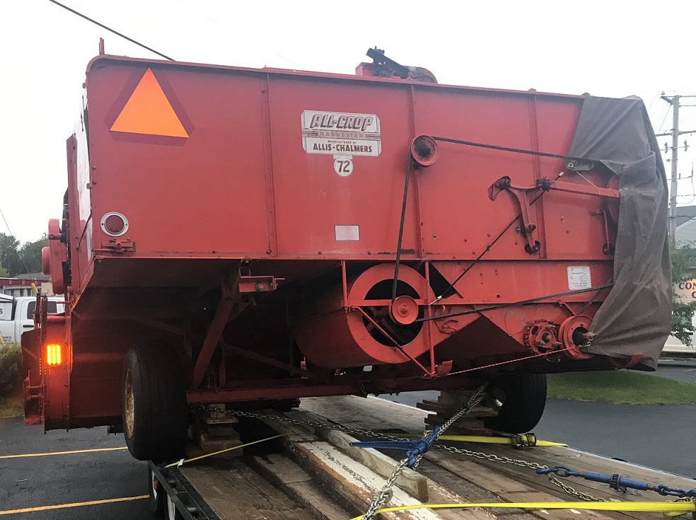

Any 102” wide trailer will work. No dismantling required . Just have the hang over on the right side on put on a couple of flags and/or flashers. In the pictures is a 66 All Crop. The tread spacing should be the same on the 72 has the 66. The header will over hang an extra 6”-8”.
Sorry for the image size

I hauled my 1969 72 All-Crop on my 102" Deckover. One plus you have going for you is the wheel tread is actually narrower on the bushing models than on the later roller bearing models. For me, I was able to get the bin side tire entirely on the trailer, and the header side tire over half on. I was just over flush with the trailer edge on the drivers side, and on the passenger side,the header hung over plenty - probably close to 2 feet total (could be less with the bushing wheels as I don't know if the later ones were widened equally on each side). After it was loaded, made blocks under each side of the axle so it could be bound down tight and avoid bouncing. As DennisA suggests, I put magnetic flashers on it and made the 360 mile trip without issue - no trouble at all. Personally, I wouldn't even attempt it on a 96" wide trailer, but it may be possible.

Hauled a 66 Big Bin from New Harmony, In. to Marion, In. on a 96" trailer few years back. Used a loader to back it on (carefully), once it was loaded, I removed wheels and set frame on 6 X 6 blocks, chained it down, put flags on right side overhang, wide load signs on and headed home - rode like a baby in a cradle!
