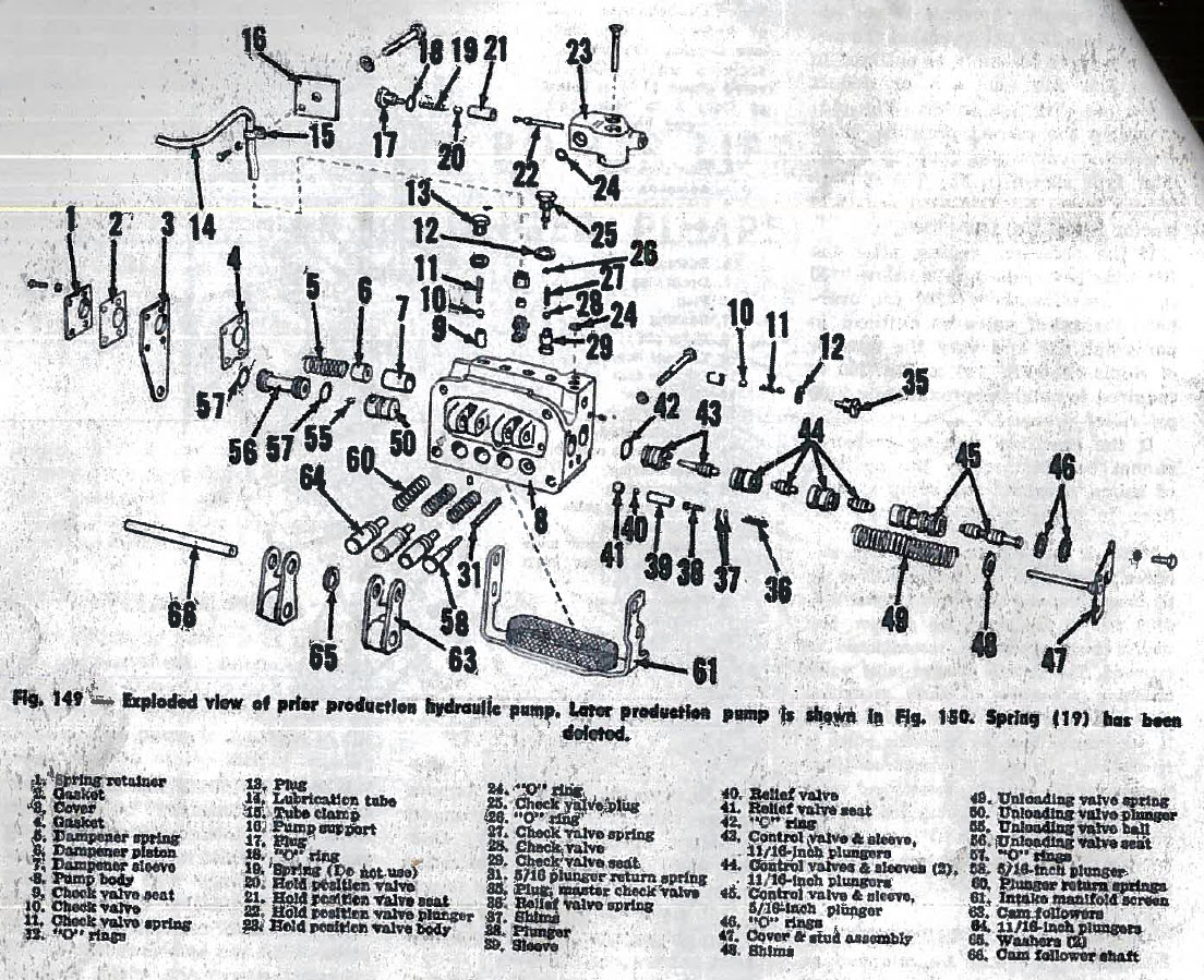

The pump in your picture is a series 111 which is a little different than yours.           MACK

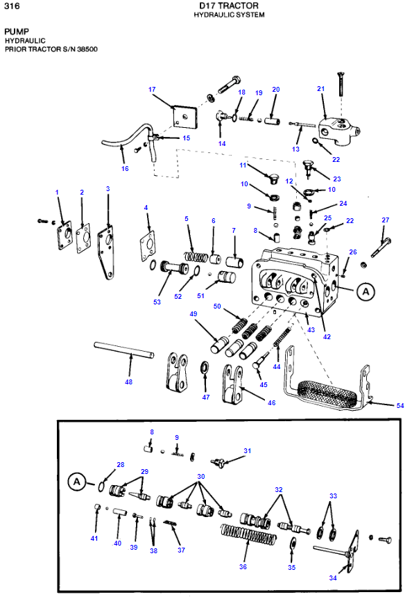

The D17 Series 1, 2, and 3 are in the same parts book. You posted the exploded view of the pump for D17 tractors prior to serial number 38500. What is your serial number? If it is 38500 or after the exploded view of that pump is in the parts book as well. Here is the link to the AGCO Parts Books. http://www.agcopartsbooks.com/partsbooksn/login.aspx?region=northamerica     Sign in as a guest user and search D17 and you can choose the catalog for all but Series IV. The exploded parts views of the pumps are in it.

Here is a pic from my shop manual of the early type hydraulic pump for reference

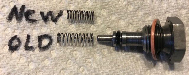

Hey guys, I ordered #24 (spring) which came with the ball for the check valve from the AGCO dealer.  But what they sent me are a little different in size than what came out of my unit:
Original ball: 0.250” dia
New ball (70915903): 0.21875” dia
Original Spring:
New Spring (70233106): spring is about .25” shorter
What would you guys do?

Here is a pic of the old and new #24 check valve spring.

Yes, # 20 was the leak down problem. While it is down, springs # 9 and 24 should be replaced do to ware. Orings 33 and 22 should be replaced. Replace 2 # 52. In your last picture, new spring looks right, that oring should be replaced. Some pumps use 4 of # 9 others use 3 of # 9 and one of #24.   12-52-33 yes.

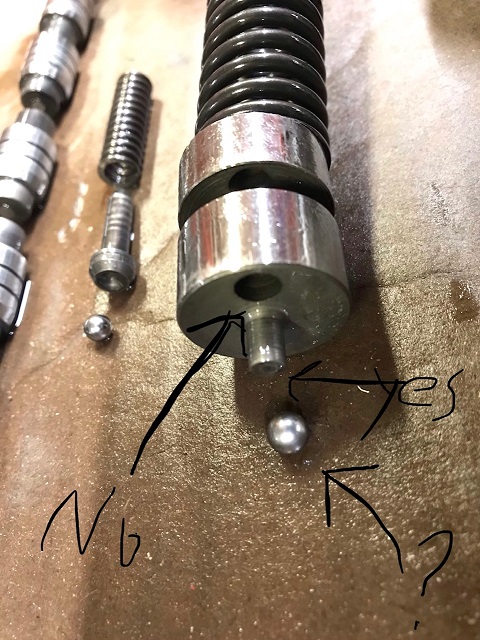

Question on where the unloading valve plunger ball goes.  I think it supposed to reside centered where that protrusion is on the unloading valve plunger?  But it also does fit it the hole I am pointing to in the picture so I am not 100% sure.

It goes on the point of valve.       MACK

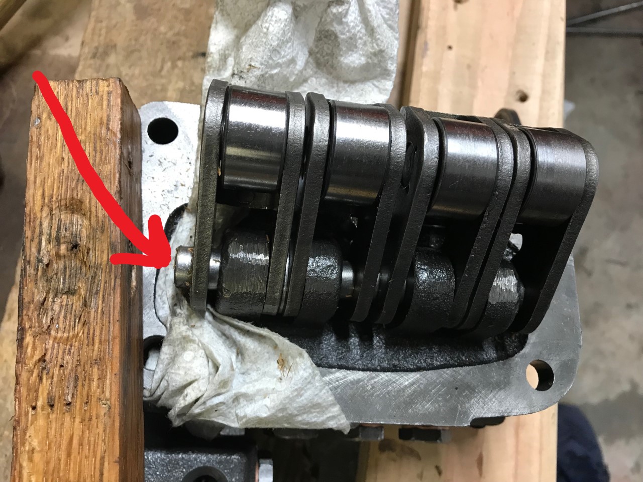

Is there a trick to getting the pin out to get the cam followers and pump plungers out?  I was going to replace the plunger return springs...  I have been tapping it with a 3 lb sledge (with wood block between) while pushing the cams/plungers up and down with one hand to take the pressure off the pin I am trying to remove.   Can't get it to move either way.
MACK View Drop Down
Joined: 17 Nov 2009
Points: 7664
Post Options Post Options   Thanks (0) Thanks(0)   Quote MACK Quote  Post ReplyReply Direct Link To This Post Posted: 03 Mar 2019 at 9:30pm
Use a hammer and soft punch. The shaft is so hard you won't hurt it. A hard punch against a hard shaft could flake off causing danger to you.     MACK
