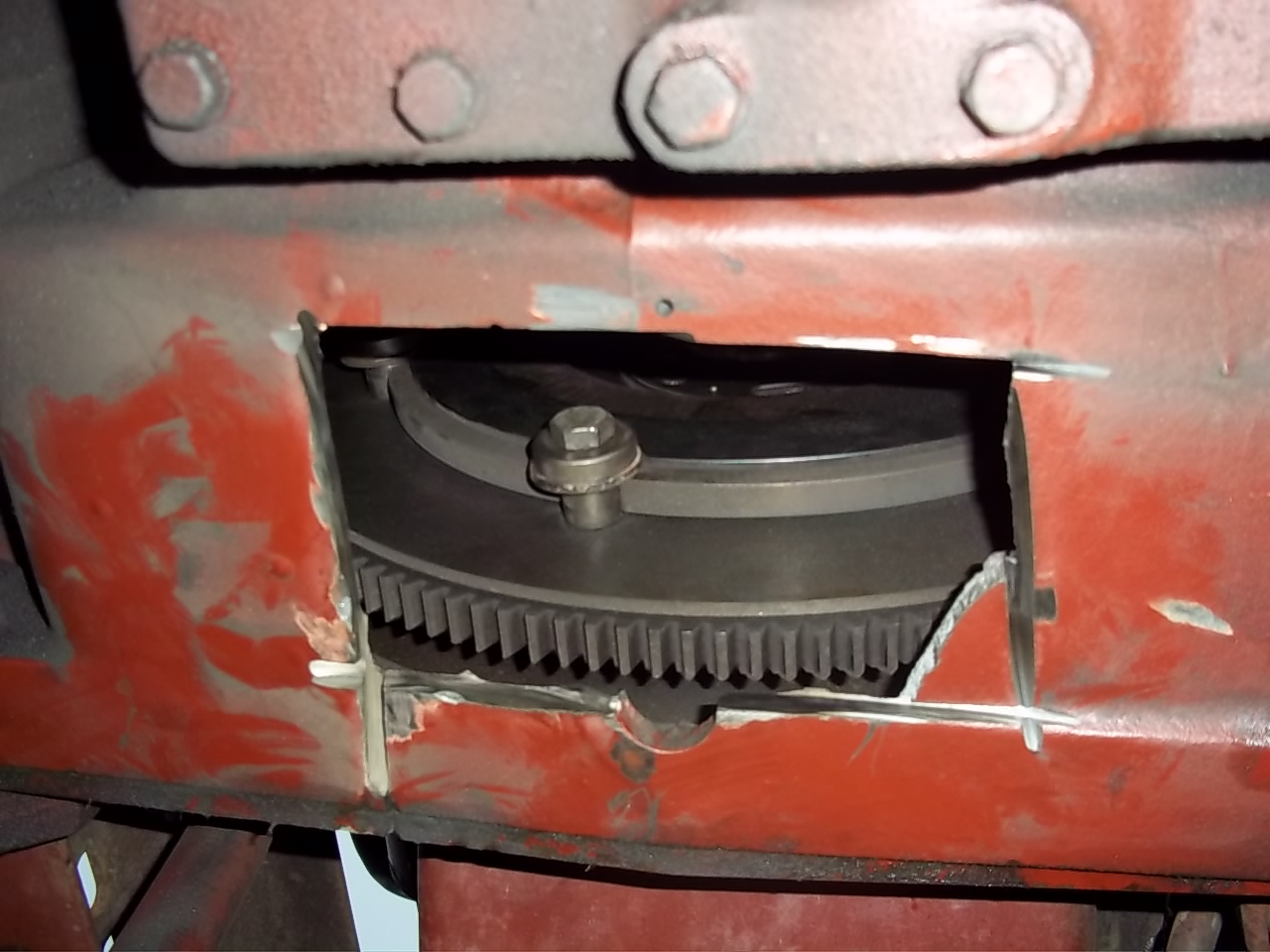

Who remembers this torque limiter repair?
AllisFreak MN View Drop Down
Joined: 07 Dec 2009
Location: Minnesota
Points: 1594
Post Options Post Options   Thanks (0) Thanks(0)   Quote AllisFreak MN Quote  Post ReplyReply Direct Link To This Post Posted: 26 Jan 2019 at 8:00pm
Ahh yes, I wonder how that one is holding up......?
