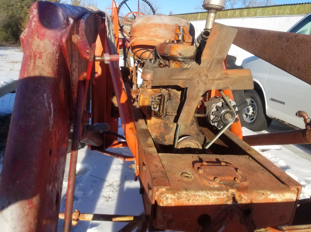

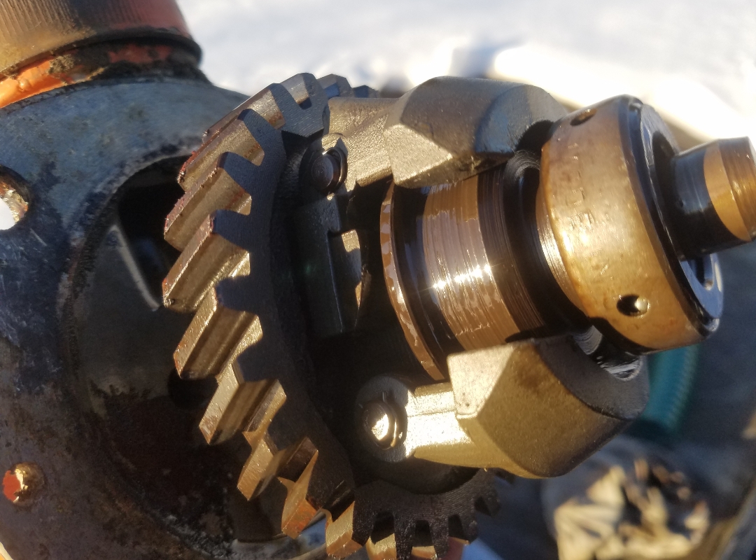

Dr Allis has given you some things to check. I see you have a picture. So you have removed the govenor/ distributor housing. I assume that the weights move freely? All the linkages can be suspect and worn at the joints too. I had one that had a mind of its own. Had to go through all the linkages and make adjustments and correct worn joints in the linkage system. Also there is a big spring under the tank on the right side. Make sure its hooked up correctly. Pictures can help us help you too.

Oh yeah. I went in baby steps taking it apart today. I did see the big spring under the tank. The linkage does not look especially worn. Now on the governor lever by the alternator there is a little clip should there be a spring on that?

Whatever the he77 is strapped to the side of the vertical governor arm....GET IT OFF OF THERE  !!

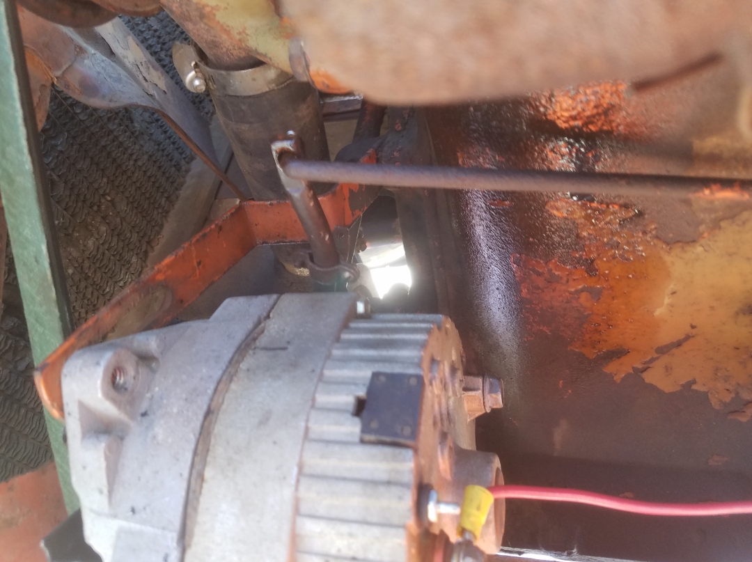

There's nothing attached to that clamp on the governor arm is there? Because there shouldn't be anything there. Looks like a PO was jerry-rigging something to get around past problems with the gov. instead of fixing it properly, I would just take the clamp off. I see there's an alternator on it also, the elbow of that arm looks real close on that side, it's not hitting/binding on the bracket or alt body is it? Check the position of the arm for free movement throughout the range of the throttle lever.

First thanks for the pictures. It may help as folks have already seen some things. For some reason and maybe its just the angle of the picture, but the govenor arm looks like it may have a bend in it? IIRC they are straight. that could be affecting the length of the throttle rod to the carb?

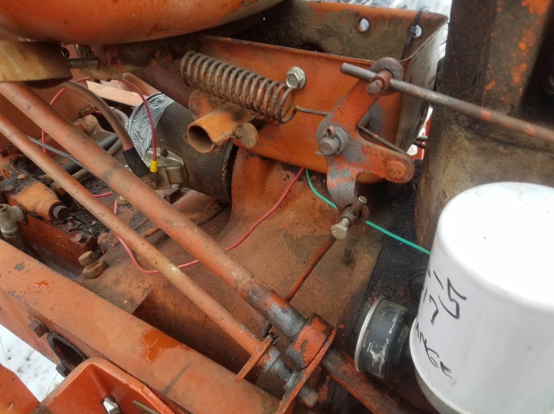

Also in the first picture for some reason the governor spring looks twice as long as I remember? Could you get a close up of that? Please.

Just because the vertical governor arm is bent like that doesn't mean it's wrong. The key is the synchronization of the arm hole position to the carbs throttle shaft opening. Many arms have been bent like that and some the other way. Synching is key, not what it looks like.

Sugarmaker, that is with the throttle all the way down. It just stretches the spring and does nothing else. Is that supposed to do that?

The governor arm barely clears the alternator. My friend stopped over and worked the arm some and we felt it free up. I kept squirting triflow in both ends and it got better and better. Now when I move the lever it moves the throttle on the carb. I'm putting it back together right now.

Does this stuff look correct?

Thanks for explaining the picture of the extended spring too. I thought that might be what I was seeing but had never seen it stretched I guess.
Hope it runs much better. The rods and adjustments under the tank look about right. There is a adjustment that can be made if necessary to the length of the rod from the governor arm to the carb. Dr Allis and others are good at explaining how to check this.
