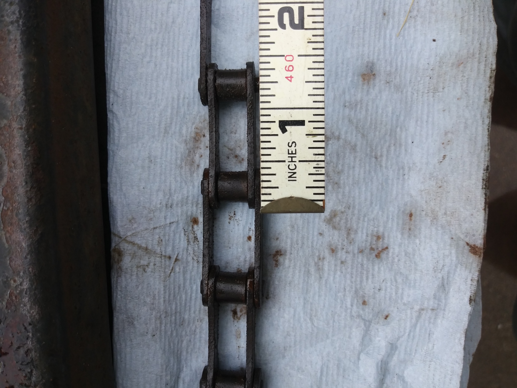

Need to replace the chain on the rake.  The old one is too stiff to be rehabbed.  Everything at the local stores has links that are too narrow.  Won't be able to check with Sandy Lake till Tuesday to see if they have one.  Meanwhile, is there a source for aftermarket roller chains that are compatible?

Bad perspective on the ruler - about 1 3/4" for the side of the link

It should be regular 20-50 chain. Most implement dealers should have it
