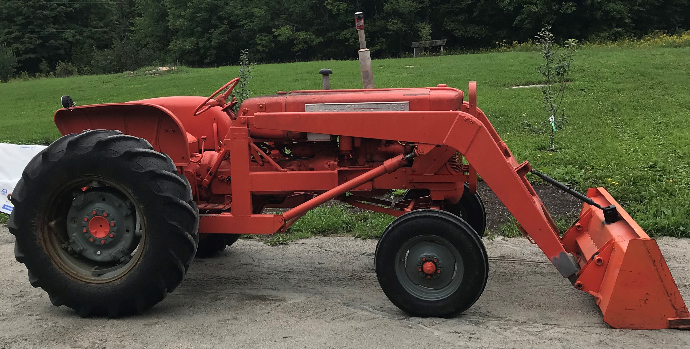

Hey guys i need some help. My D15 II keeps backfiring when i turn it off while running everything runs smoothly i don't know what the issue could be the muffler is a little sketchy and not taken care of it has aluminum foil and a hose clamp holding it up.....in the process of fixing it but wanting to know if this could be the cause of the backfiring. Any help would be great!!!!

That is NOT a series 2.

Its not a series II DrAllis but doesnt it have the thumb guard?

All D15s have the thumb guard regardless of series.  My 1961 Series I has it, so does my 1966 Series II.  Yes, that is definitely a Series I you have there.  A few less ponies, but still a great tractor.
