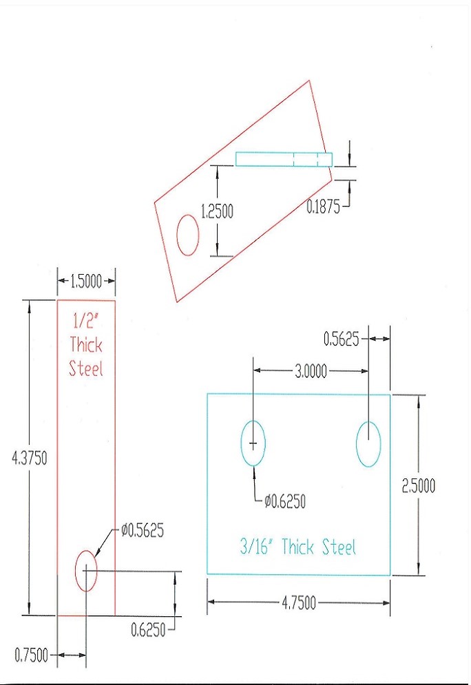

I'm currently resurrecting an 80R mower for use on a D14. I'm missing the brackets that attach to the right axle housing that the balance spring attaches to. Anyone have these brackets that would be willing to take a few pics and a few measurements for me?

I will try to get some.  Here is a drawing with some dimensions.  It is from another forum member.  I have some notes as well I will try to add that are on my copy of the picture.

That's just what I was needing!
Thank you!
