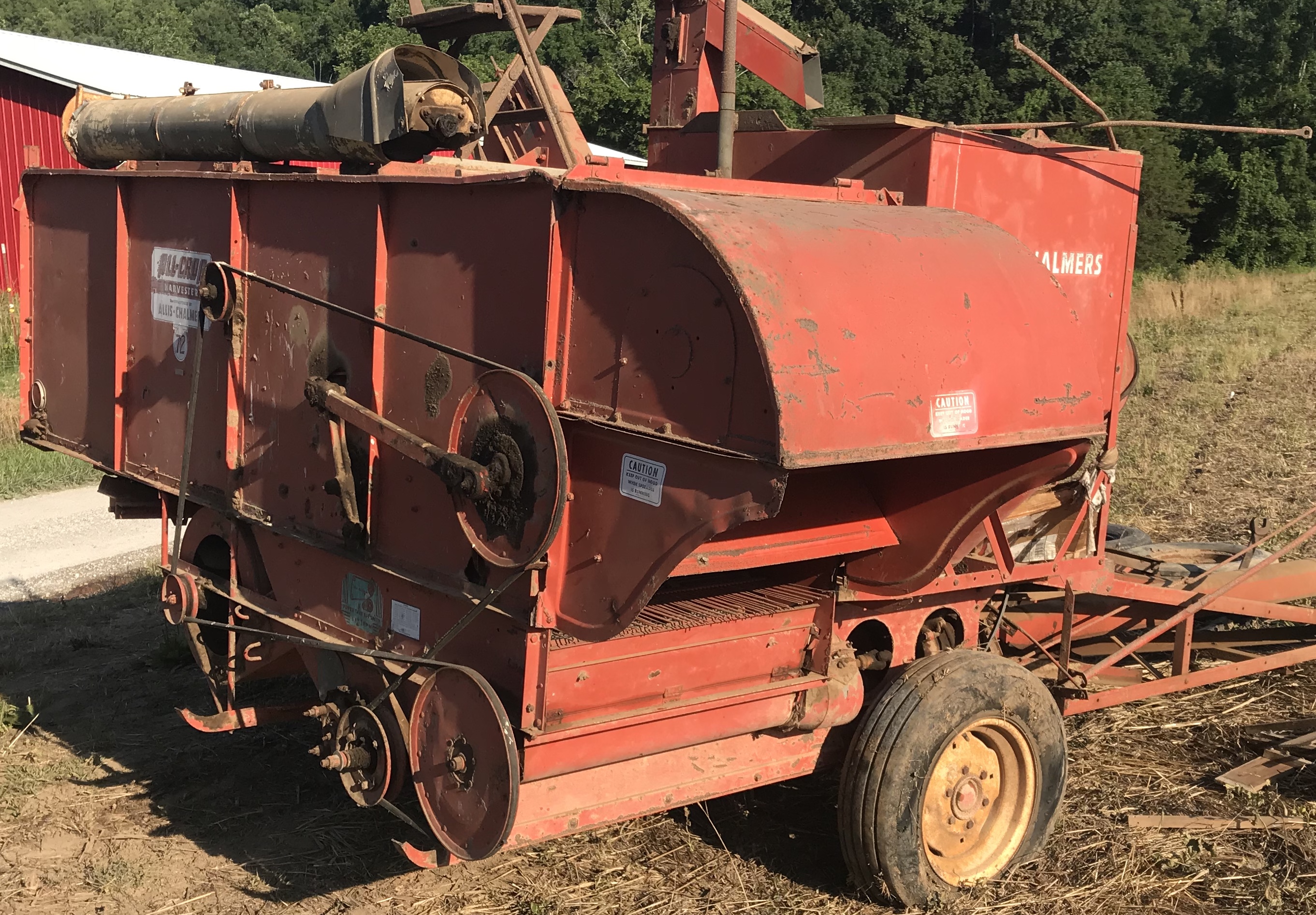

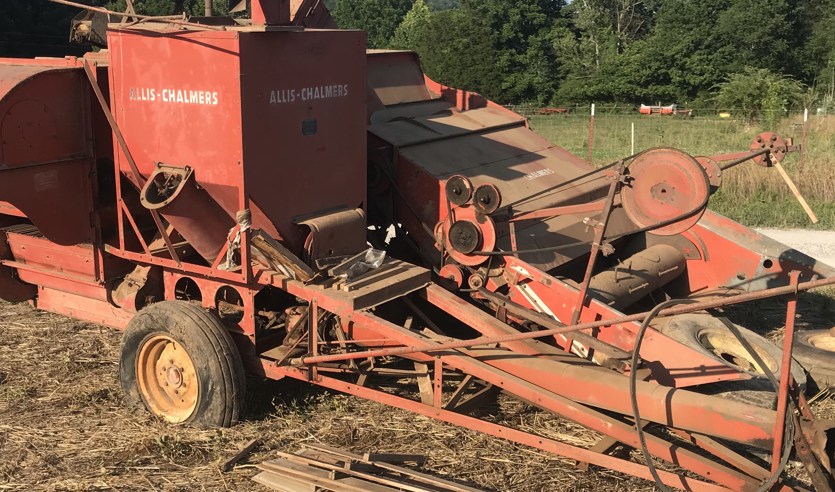

I don’t know that the picture worked but we got a 72 all crop college bought it new. I’m on a little vacation at some drag races in ky. But we bought this to combine orchard grass can anyone give me some settings for small seed like orchard grass.

Oh and another thing they pulled this thing I guess 50 or 60 miles on the original tires. One blow out right in the drive way. They said this thing pulled perfect

Thanks guys those settings are those just grass settings and then fine tune it or is that pretty close to orchard grass specs. I turned it on this evening about 30 minutes ago put the reel together someone had the belt tension off that drives the reel. I’m planning to us it tomorrow.

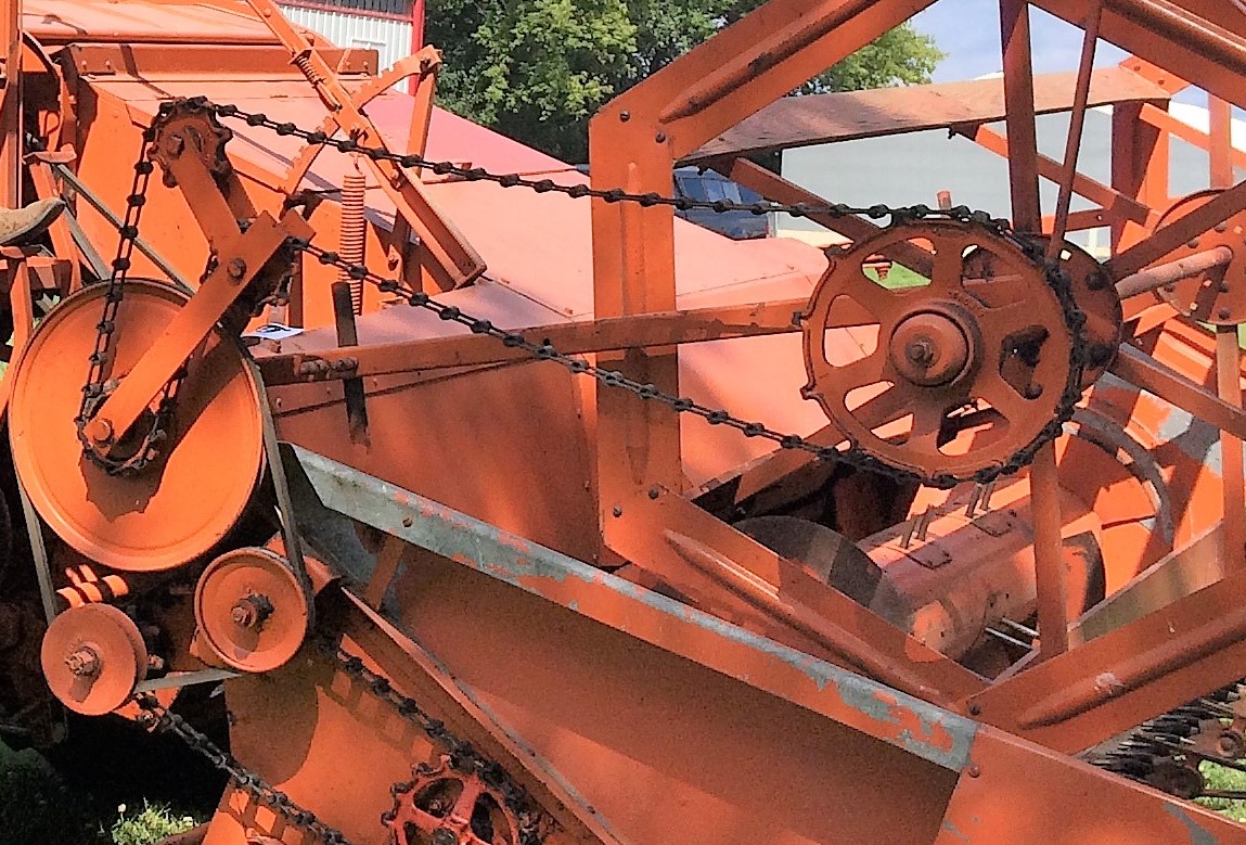

Also, your reel belt in the above photo...it's routed upside down. Here's how it should be. It's a huge "pet peeve" of mine when they are routed upside down. The point of the high-clearance drive is to keep tall crops/weeds from tangling in the chain/belt. I don't know if guys just don't remember how it's supposed to go or they just don't care. Either way, it's like nails on a chalk board to me.
This is a Super 100, which uses a chain drive, but it's routed the same way.
