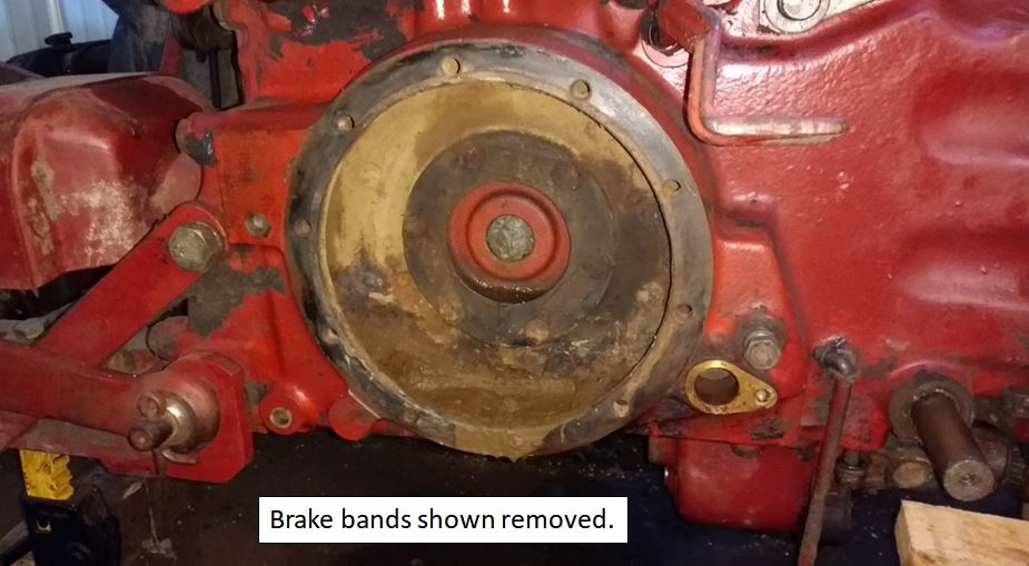

It's likely you'll need a torch unless your pins aren't rusted to bad, then you may be able to just pull them out.I did both sides of the brakes on my 5050 a few months ago, but I did end up using a torch to cut out the old bands and then pounded out the pins with a punch.

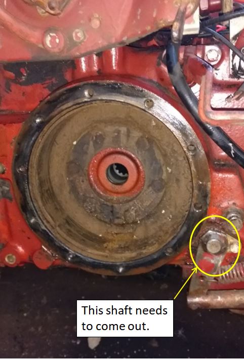

The pictures I have may not be real useful, but here they are. The side shown in the pictures was the most difficult to remove because they were filled with muddy, rusty gunk. The brake lever shaft needs to be removed first and I had to heat the tapered bolt holding it onto the lever also.  Putting the brake bands back in can be tricky, but with patience it is possible.

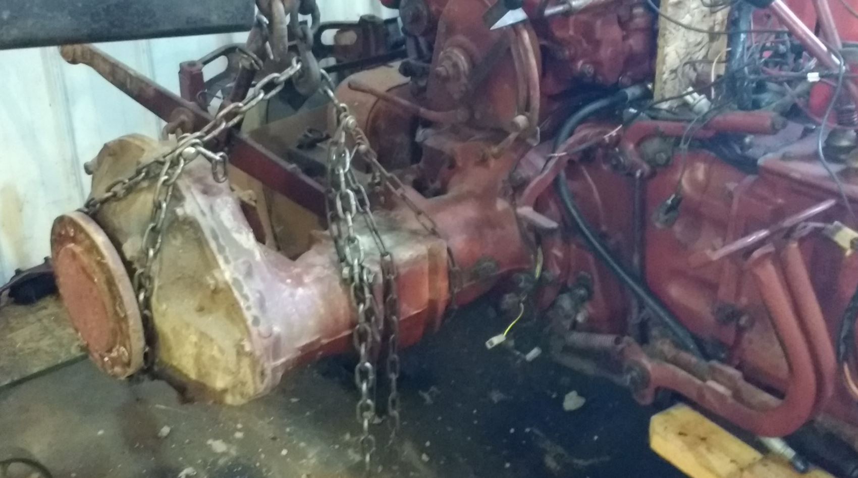

What'd you use to yank the finals? Engine hoist?

I used an engine type puller or 'cherry picker' to remove the axle housing. I did find one picture with the chains attached to the housing.
