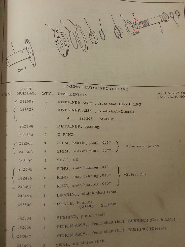

Post Options Post Options   Thanks (0) Thanks(0)   Quote cncman08 Quote  Post ReplyReply Direct Link To This Post Posted: 07 Feb 2018 at 6:56am
uploads/17006/20180207_0642191.jpg
Is the bushing I circled in red the one that could be causing the issue?
Points: 21838
Post Options Post Options   Thanks (0) Thanks(0)   Quote DrAllis Quote  Post ReplyReply Direct Link To This Post Posted: 07 Feb 2018 at 7:25am
Yes.   I've only ever had one that did it and it was a tractor from some other part of the country that was purchased at an auction. You simply had to grind gears most all of the time and it wasn't the clutch or pilot bearing. It was this bushing dragging the clutch shaft along with it. There are far more out there that this has never bothered, but once in a great while there is.........
