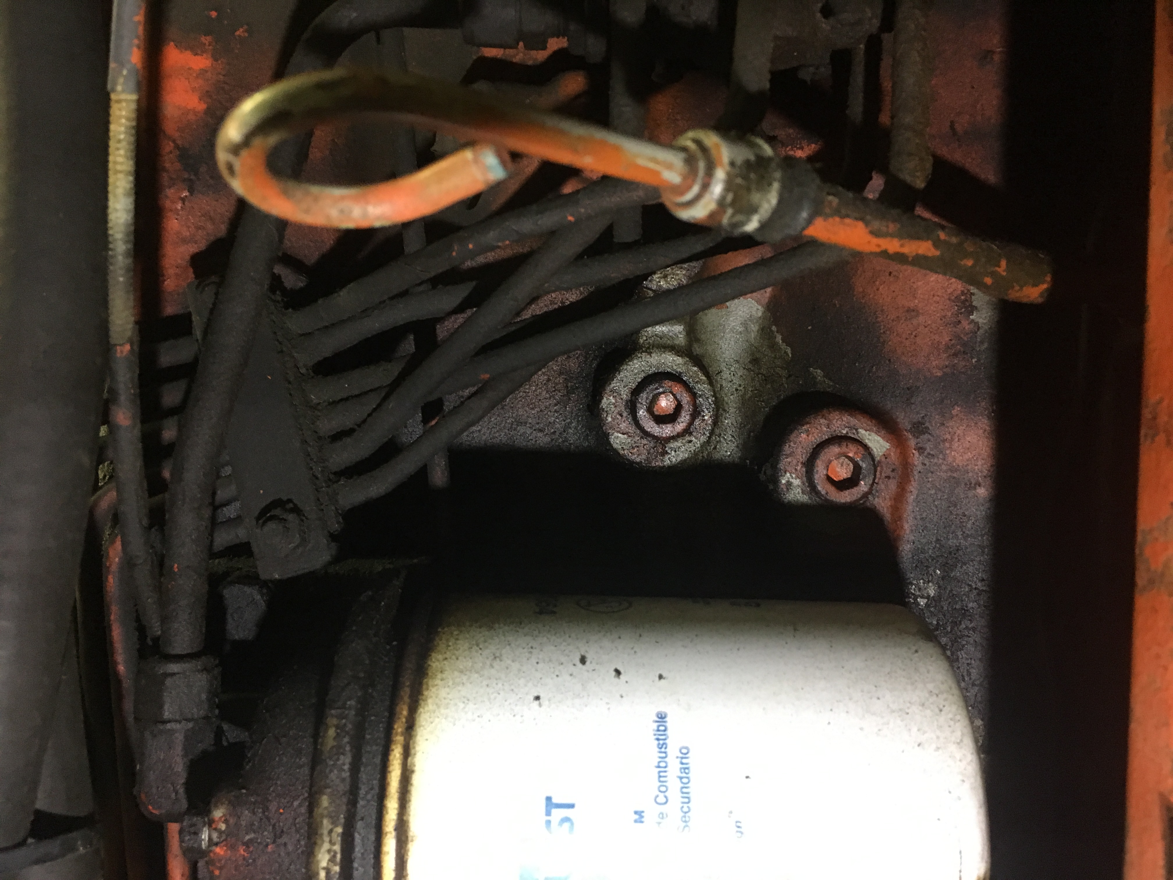

studer automotive View Drop Down
Joined: 10 Sep 2013
Location: jeromesville,oh
Points: 566
Post Options Post Options   Thanks (0) Thanks(0)   Quote studer automotive Quote  Post ReplyReply Direct Link To This Post Posted: 28 Jan 2018 at 5:57pm
Are these ^ the oil access gallows I need to use for the oil lines?
