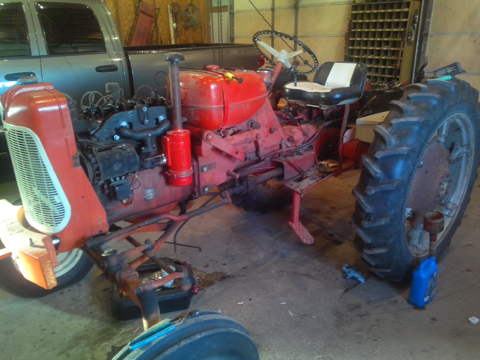

. Putting new manifold on today!

I like your front weights, what'd ya steal em offa?  took me about 2-3 years of scroungin, to find a series 3 weight, fer my D10...

Post Options Post Options   Thanks (0) Thanks(0)   Quote allis1221G Quote  Post ReplyReply Direct Link To This Post Posted: 20 Jan 2018 at 6:25pm
Bought another d-12 with the weight on,took it off and sold the tractor for 1500 more than I paid! It's the only way you will find the weight unless you steal it! Lol
