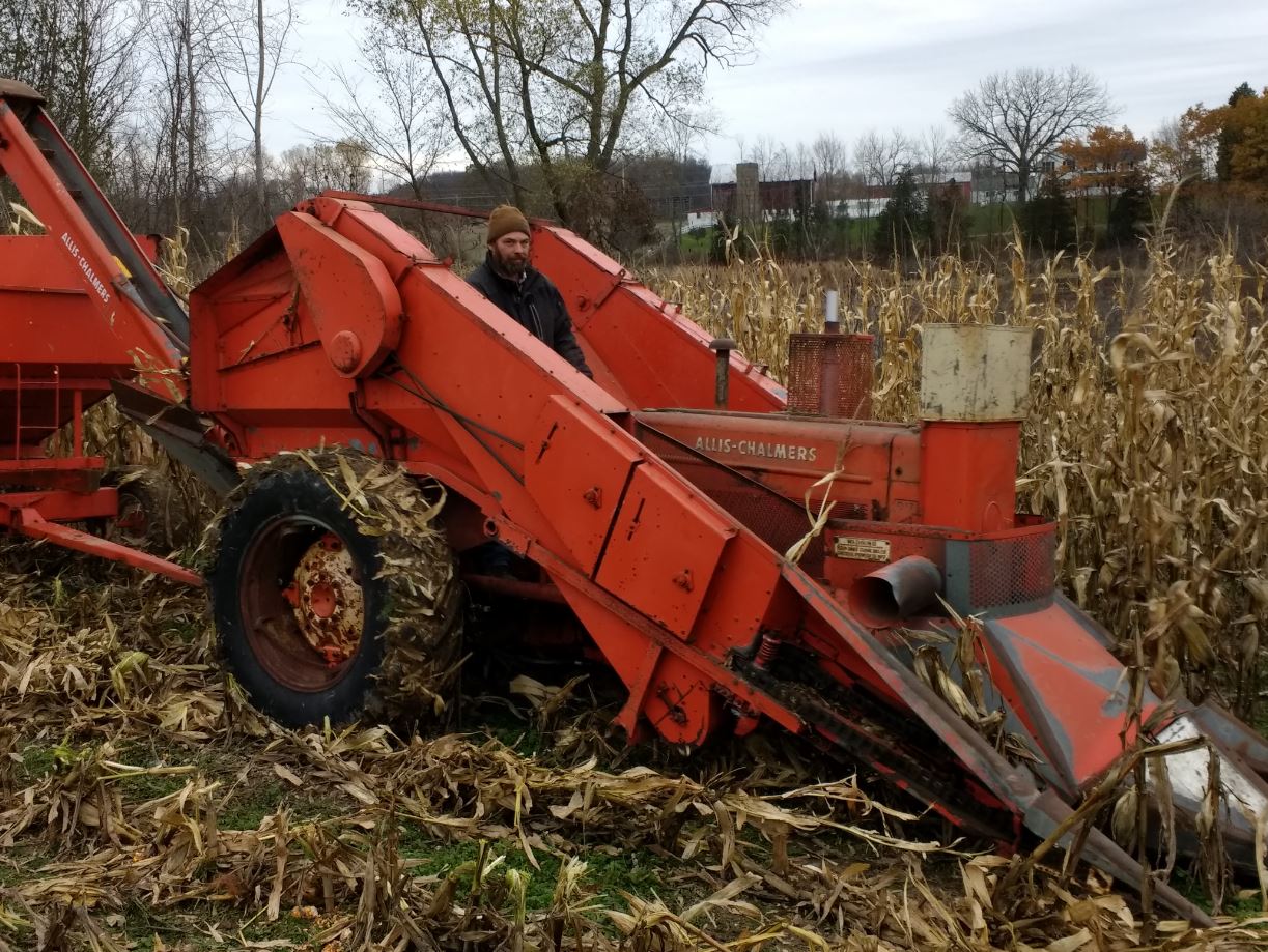

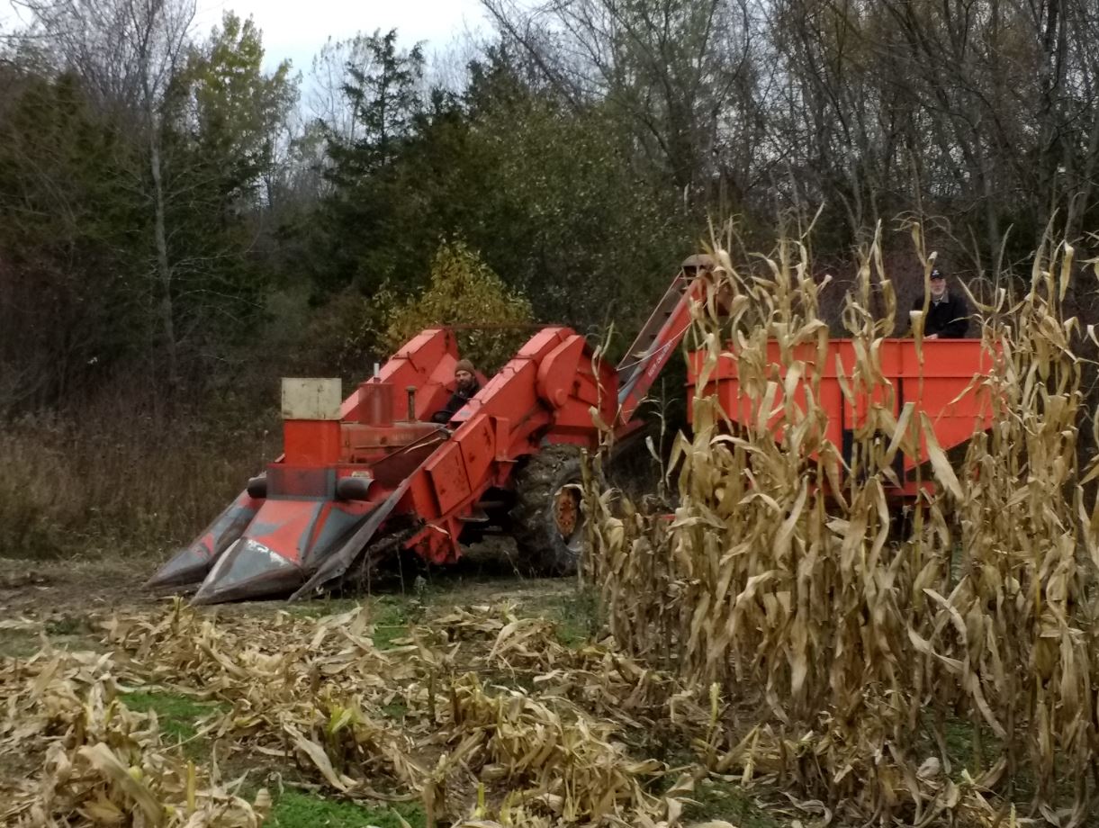

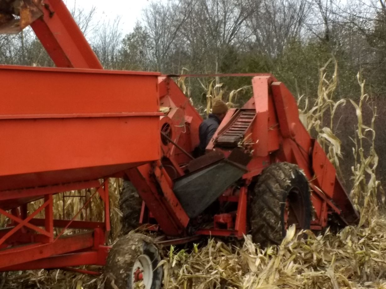

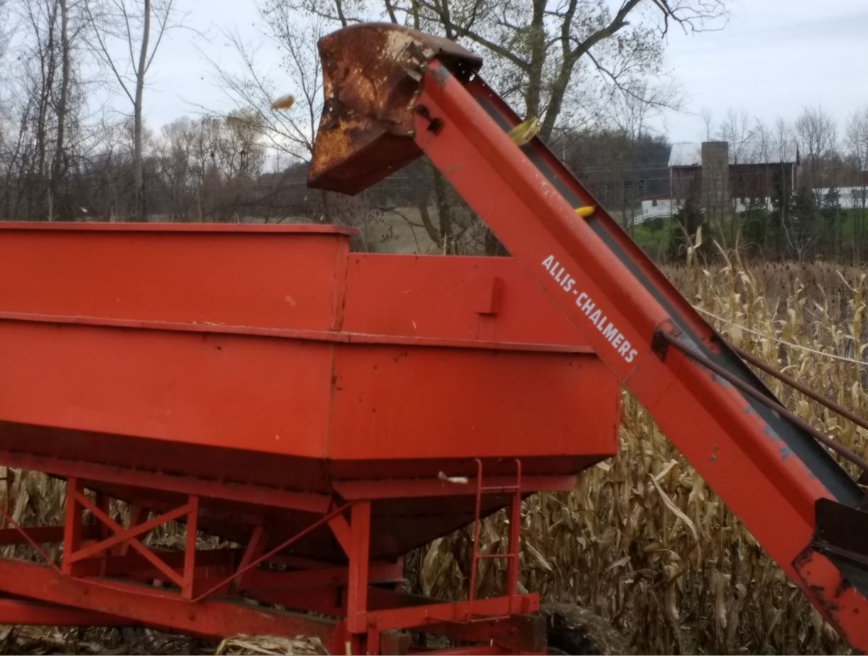

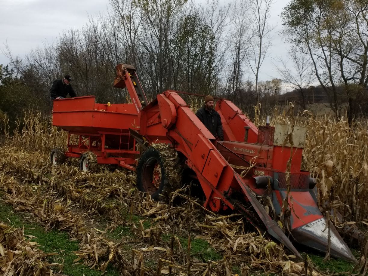

Had some fun this past Saturday picking corn with friends.

Awesome pictures.
How hard is it to take off and put on the picker?

This is the second year of my using the picker, last year is husked reasonably well, but nothing to brag about. This year was worse, the corn was planted late and there still seemed to be a lot of moisture in the stalk.
The picker is not as difficult to remove as it may appear if you leave the lift cylinder mount attached to the tractor. 6 bolts and undo 2 chains for the elevator. Remove 2 bolts up front for the lift mechanism, install jack stands, remove 2 more bolts at rear, detach 2 more chains then back out. The rear sub frame can now be removed by putting down the jack stands, removing 2 wedge locks and driving away.
Of course putting the picker back on takes a little more patience to get everything lined up. Parking on a flat concrete slab will make the job much easier.
All that being said, I never took it off last year and don't plan on it this year either.

Bozrae , thanks for posting pics. I have never seen a screen box around the muffler. Is that homemade or a manufactured piece ?
