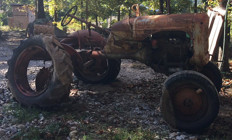

Here is the old B, which apparently is a '38. Just for the record there is an issue with uploading images to the forum, for me, from an iPhone running Firefox. I spent over 20 years as a graphic designer, and web developer, so manipulating images is nothing new to me. I use a Mac and own the latest copy of Photoshop.
As rough as the old beast looks the rust on the sheet metal is limited to the surface. It is not my plan to make it as smooth as a new car. My goal is to preserve and protect from further degradation. Anything would be an improvement over the sad condition in which it now exists!

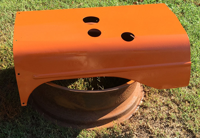

Above is the results of removing the rust, and dead paint, from the hood and with a fresh coating of paint. As one can see the rear rims are gone. When I moved-drug the tractor to this position the right rim collapsed, so until I get shoes on it here is where it will stay. A good tarp awaits wet weather.

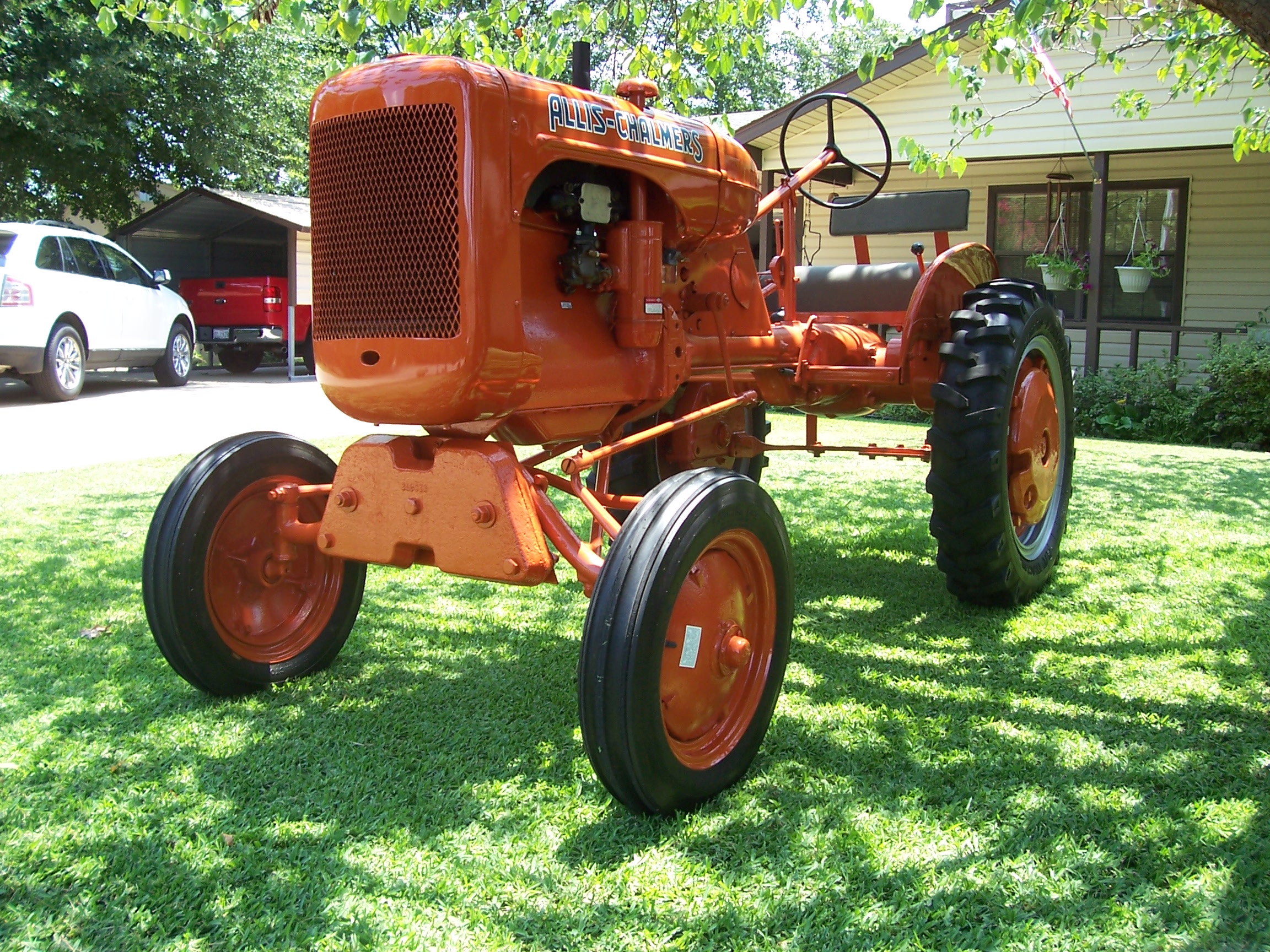

Here is a photo of a Early 38 B #751 I had a hand in finding the correct vintage 1938 bits and pieces for a historically accurate restoration. Lots of what you see here became obsolete in 1939. In other words used in 1938 only. List is pretty long.
     My best friend lost interest  after Restoring 2 AC Tractors. This 38 and a 55 IB were both sold to collectors in the past year and a half.  After this picture was taken a correct pair of Single Rib 5 x 15 front tires from Miller Tire replaced the Tri Ribs

Ken,
That is an absolute cutie! I love the wheel and front end weights.
The main goal for me is not to produce a show tractor, but rather to just end the downhill slide and protect it.
I have a belly mower, flail mower and finger rake for it.
