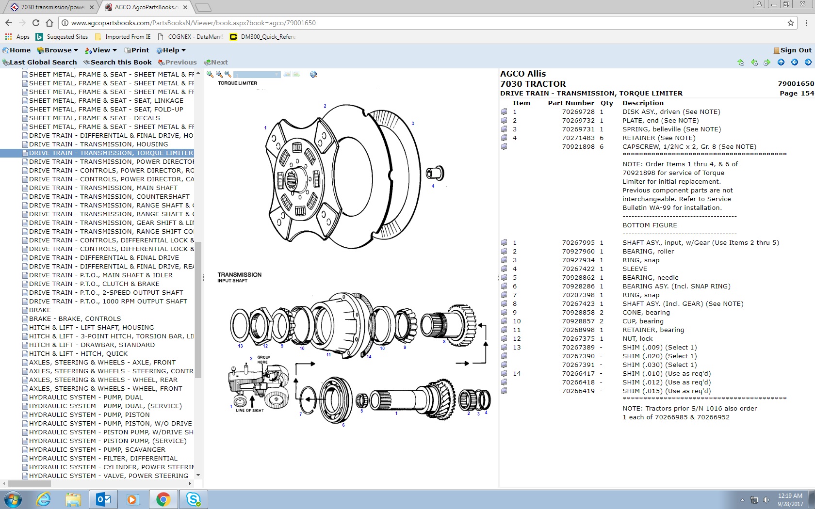

Also 3 of the belleville washers were broken in pieces laying in the bottom of the case, another is cracked so all those need replaced as well. There was also what looked like needle bearings laying in there, but I don't see where a needle bearing would be, and the parts book at the AGCO site doesn't show one in the assembly.

The parts from the needle bearing are probably from the one that goes inside the smallest hollow shaft that engages in your power director, which is number 5 in the attached photo.  When I did my 7050 the bearing fell apart into the power director too.

Thanks Wayne, I bet you are 100% correct. I haven't tore it completely apart yet.
