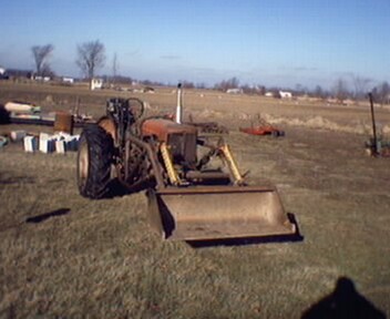

I built a 5' bucket and put hydraulics on  an old WD45 I used to have and filled in around the house when I built in 1996,moved over 100 ton of dirt,dug out where my pond was gonna be,worked pretty good.
