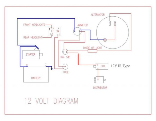

I have a 1952 Farmall Super A. I took the Alternator off, replaced the "B", "1" and "2" wires.  Used the multimeter red lead to "B" which is also connected to the "2" and black lead to case of the alternator (alternator is removed from the tractor) and checked it by putting drill on it and it does produce a current at the low rpm of the cordless drill. I used the attached wiring diagram. I have replaced all wires on the tractor except for the lights, light switch, and fuse. (Just didn't get that far). I did not put the warning light/diode on either because I didn't have one.

Other than the fact that the warning light/diode and lights are not connected (not drawing the alternator down), I don't see why it is not shutting off. There is a white two terminal porcelin block under the gas tank that has nothing connected to it.

When you say "diode & light not connected" do you mean there is a solid piece of wire there instead? If so, that is your problem. If not, something is amiss with your wiring. Try taking the 2 wire connector off the alternator after turning the ignition off. I bet the engine will stop.

Yes, I did not hook a light or diode up. Just ran wire straight from alternator to switch. I'm in the process of hooking up a light. Currently light is on when switch is pulled out and I did not try to start tractor. When I push switch in, light goes out. I'm not sure if this little light will draw enough off of alternator. It is 9/16" in diameter to fit in hole in instrument panel.

The light will. You're seeing  classic case of feedback from the alternator to the ignition coil. Either install a light, diode or 47 ohm 2+ watt resistor and your problem will go away.
