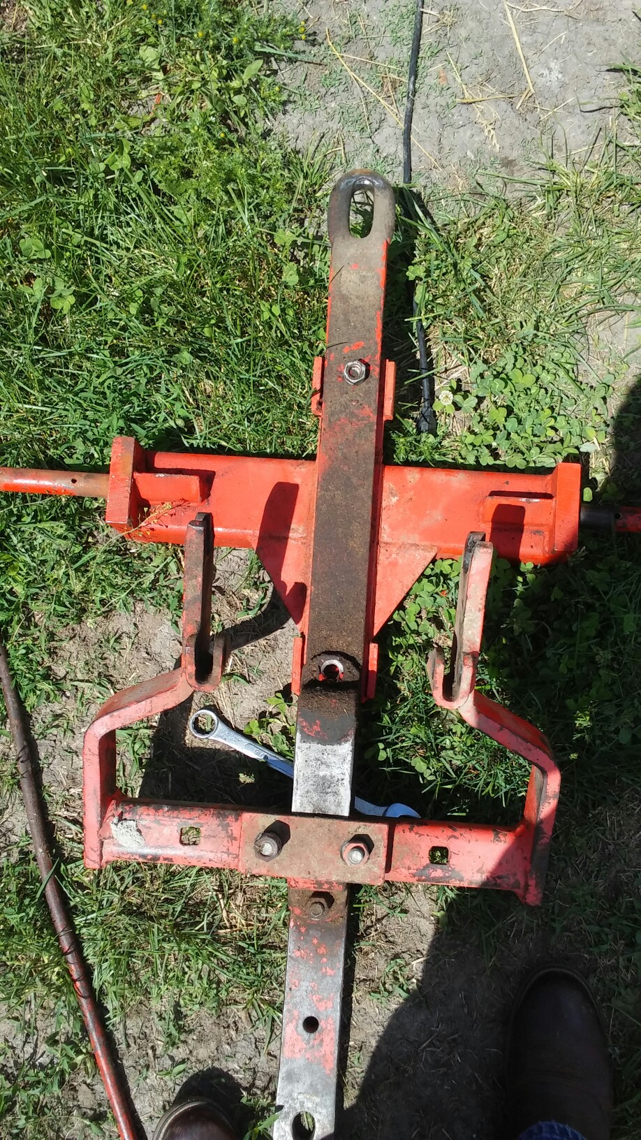

Picked up a series 4 3 pt adapter for my series 2. According to the parts book both drawbars are the same. Problem I have is one hole is about a half a hole off. Any ideas?

Ream out the adapter with a carbide bit, not the drawbar. That's what I would do anyway.

Weld a bolt to the adapter where it's supposed to be to fit the drawbar
