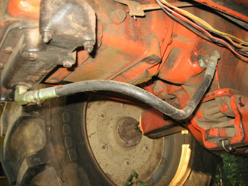

Could I use the drain plug on the left for my return on loader joystick control? This is a borrowed picture from the net. It won't be connected to the other drain.
Thanks

thats where i have mine plumbed into. havent had any issues either. i would put a tee fitting with a plug on bottom so you can drain oil without taking line off.
