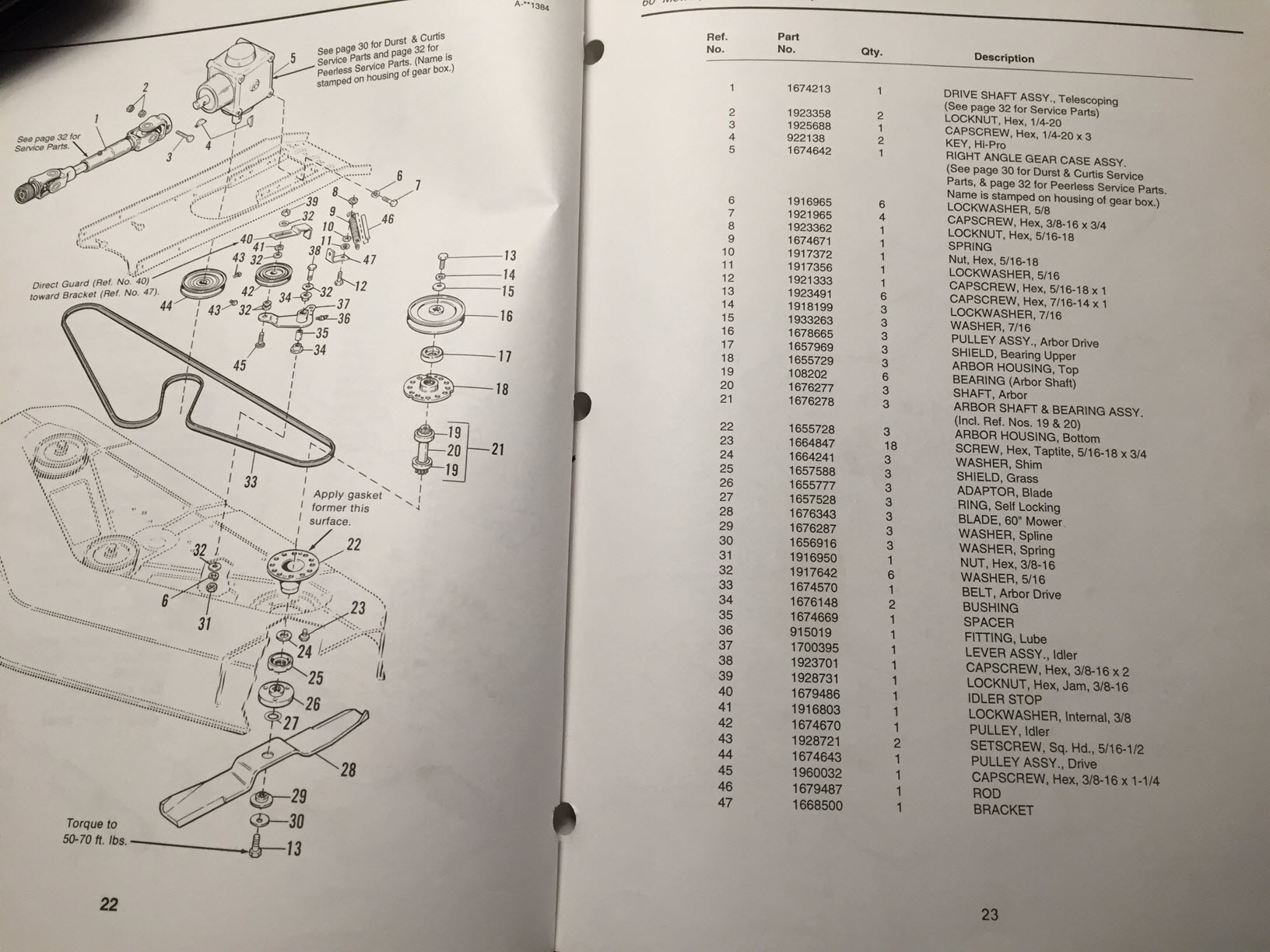

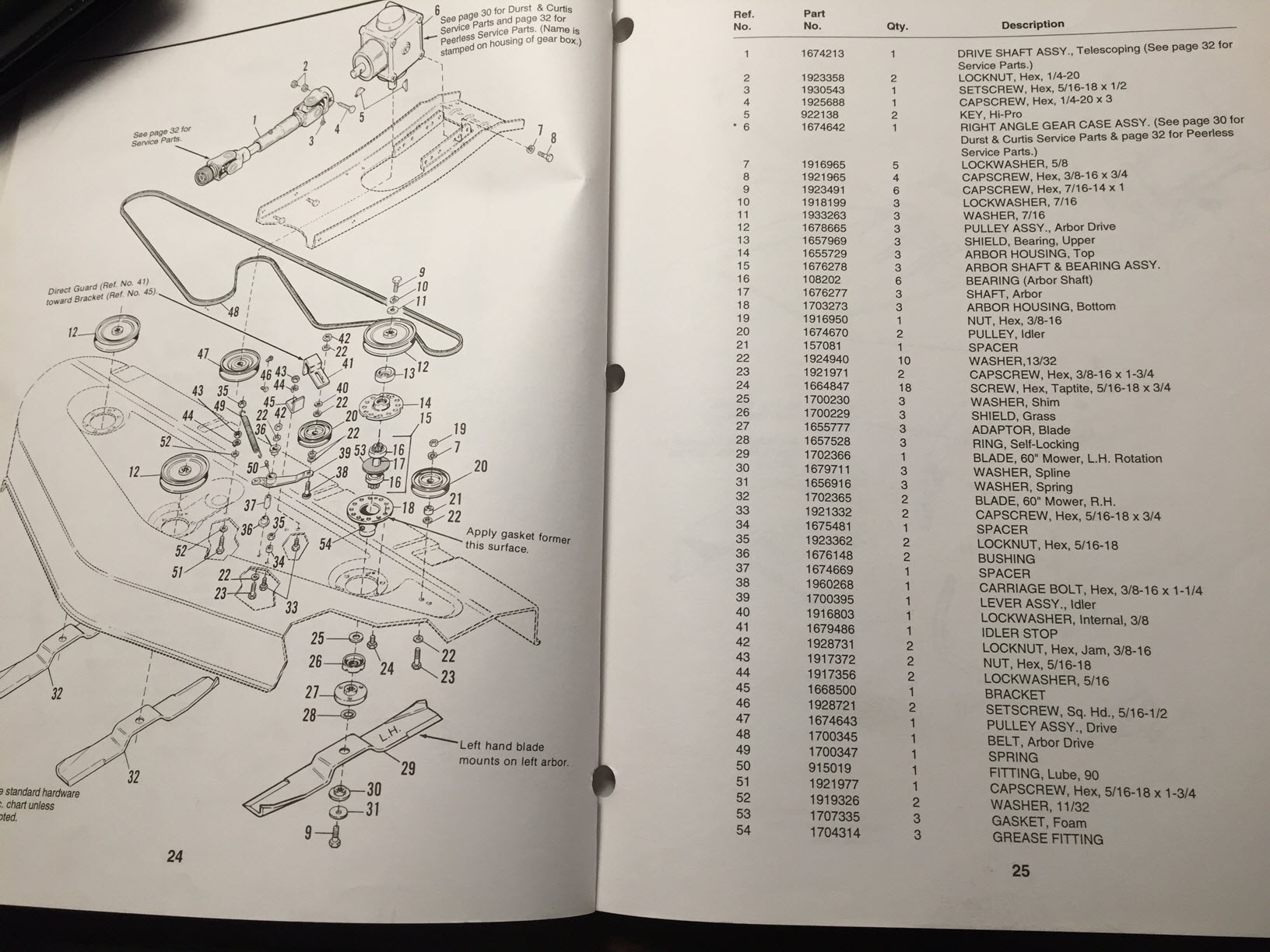

Doug, I have a Agco-Allis 1920 lawn tractor and the manuals.
I have taken 2 photos of the deck parts and part numbers for you.
I hope that this is the information that you are asking for!
