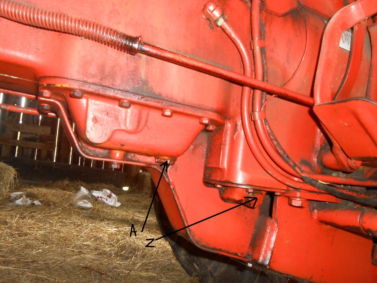

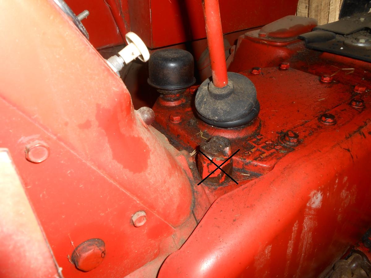

D17.  Series III.  What's the difference between these two oil plugs?  I drained the oil from both of these plugs.  Hydraulics, also power director, I believe.
I refilled here, but it only seemed to fill the "Z" one.

On a series lll, it is the same compartment .     MACK
