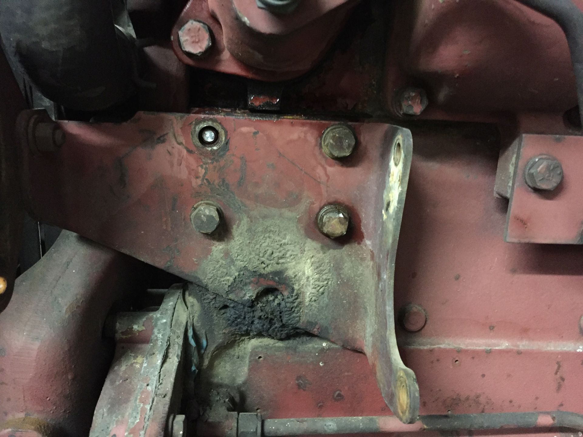

    Posted: 20 Dec 2016 at 11:08pm
I have this 7060 in the shop and we were taking all the air conditioning parts off and we were about to take the mount off when it started leaking anti-freeze. Is there a plate made on cabless 7000 series to take the place of the mount there. If so will anyone have a cabless 7000 series parts tractor to sell part to me. This tractor is going to become cabless so just wanted to take all air conditioning components off. Thanks, John

I took he plate off me 7080 without trouble. You must have another issue going on.

I'm thinking 1 of the 4 bolts was replaced and it's too long, breaking the casting of the block ? I KNOW if you use too long a bolt to mount the PTO shield on a D14 'bad things' can happen....
I'd put pan under tractor and remove the bolts,only way to find the cause of the problem.

There's nothing to leak behind that mounting plate. More than likely upper radiator hose is leaking a little where it slides over the neck or thermostat housing is leaking. Seen it many times when temp. gets sub freezing. Good Luck, Mike

Would it be an easy fix? Would it be a costly fix or is it pretty easy to fix? Thanks, John
