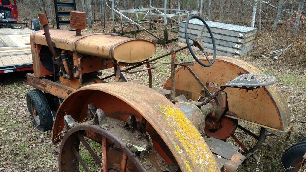

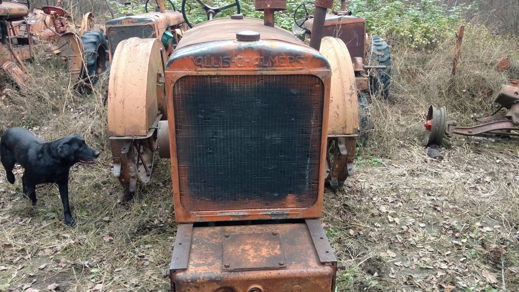

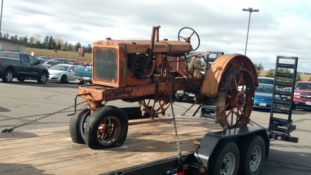

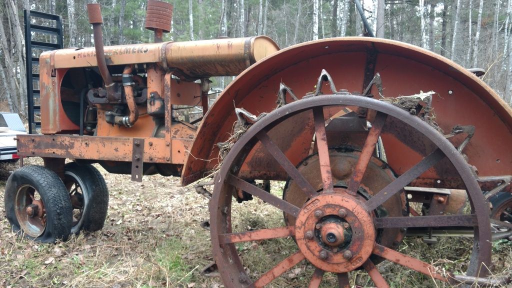

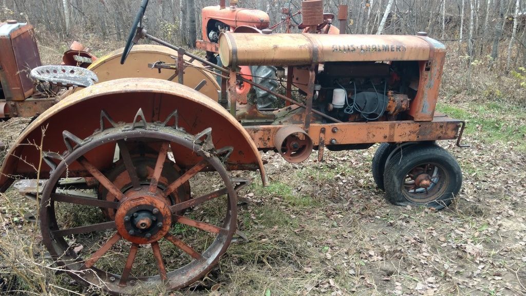

Ive wanted an unstyled wc for a whole and yesterday I went and picked mine up finally. Found it on cl for 650 bucks motee is free ,all the important parts have been covered and my buddy is gonna trade me some tin so the whole Tractor is 36 since now it has some misc parts off other years. He has about eight wc s so he let store it at his house till spring. He's confident it won't take much to get her going hopefully have it running in time for hutch next year.. ..   .

Congratulations!
If one of your tractors has the early transmission cover with four vertical bolts around the transmission tower, I would be interested in working a deal with you.

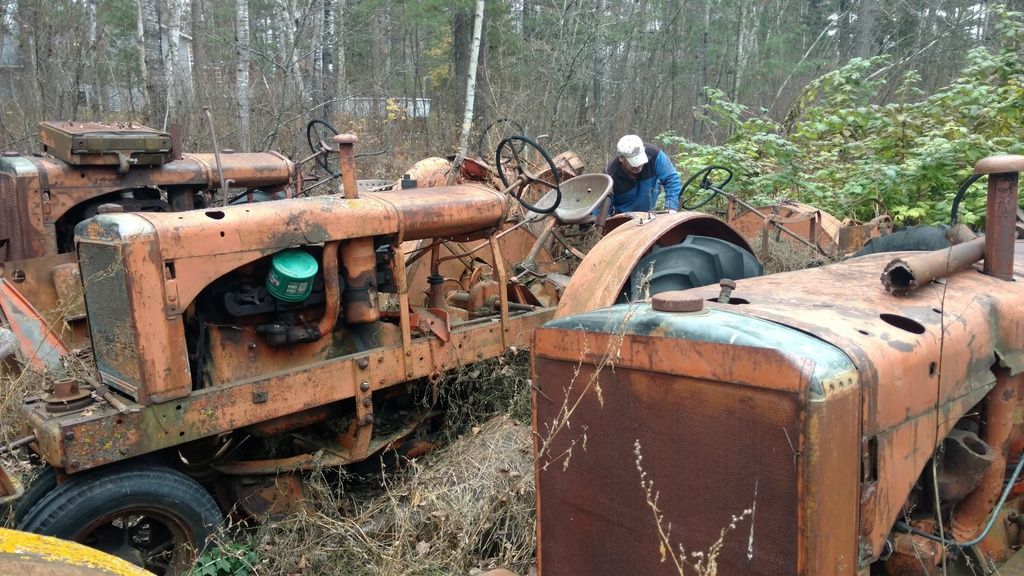

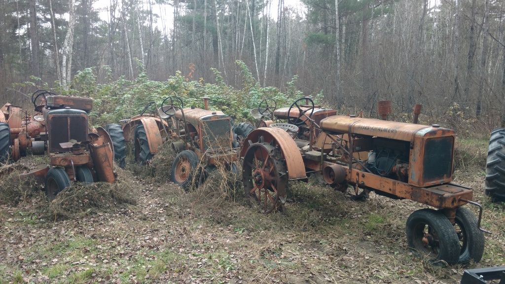

The ones in the back are my buddies some projects some parts units they're not mine . I just wanted a photo of my wc in its natural habitat lol amongst its kind

Looks like quite the honey hole there!

I always thought those were neat old tractors. Looks like you have a great project there.

Wow look at all those WCs

 Nice one Cody. I like that era of WC too. You'll have to find the right rims, and rubber tires if you want a smooth ride like you had at Hutch in 2015. lol  Tim

Nice looking WC! The fenders look perfect in those photos. Congratulations - enjoy your  find.
     I'm switching it to rubber them steel wheels were a pain in the butt to load yesterday . By next spring well have all new rubber all around and hopefully a running all 36 wc. In other news I also got my wd going again. Dang thing pooped on me at plow day two weeks ago turns out points went bad again they were only two years old too.
