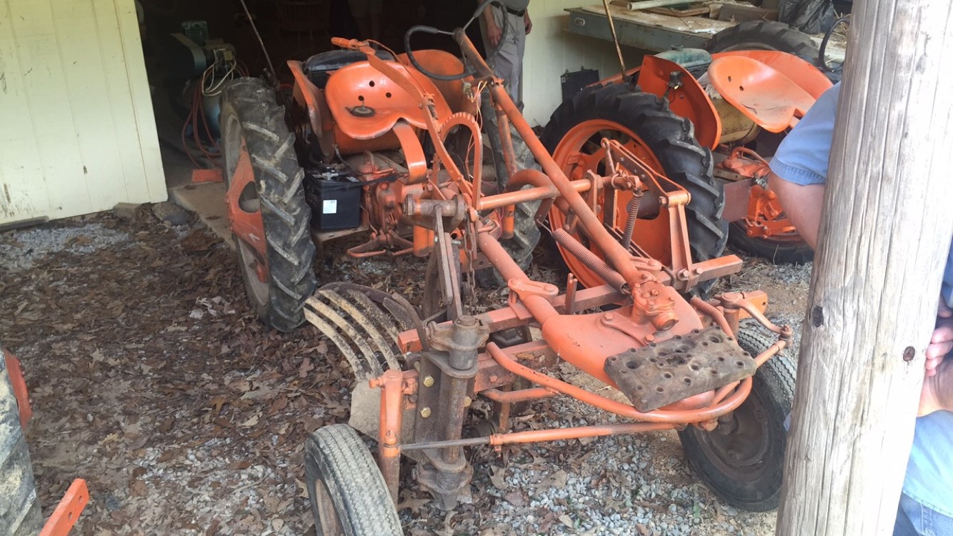

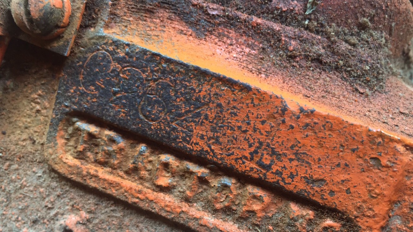

Hey guys, back in June I purchased (2) model "G" tractors. One of which has the manual lift and looks to be an early serial number. I know VERY LITTLE about these tractors and have been told to look at the number near the shifter as the serial number. Well.....that number is very hard to get your eyes on and from what I can tell, it reads "G(2,3,8)64". I can't tell whether the first number is a 2, 3, or an 8.
Is there any other place the serial number might be stamped? What about trying to date it another way such as casting codes? I own a bunch of Farmalls and you can do it to them.

That first impression is the letter G, the model letter.

I see G26461.  My G is S/N G2004. It's a 1948. Yours is later. If I had Swinford's book with me, I'd look it up and tell you what year yours was.

I see G26451.

I must be blind, and I have my glasses on. All I see is G264, no 51 or 61 after those numbers.

Take a soft wire wheel and lightly remove the paint THEN use a strong pinpoint light AT AN ANGLE look at the casting AT AN ANGLE. You'll have to 'look from at sides' and eventually you'll find the right combination to light and angle to see the numbers.

I see the G264 clearly if there is a digit after that it is very faint, more likely half a century of rust. The vertical mark after that looks like a 1 but its a different size than the other visible digits. More likely a scratch from an implement part.

Thats what I see as well.

According tp http://www.allischalmers.com/serials.html G26451 would be a 1952 model with the serial numbers for that year ending with G26496.

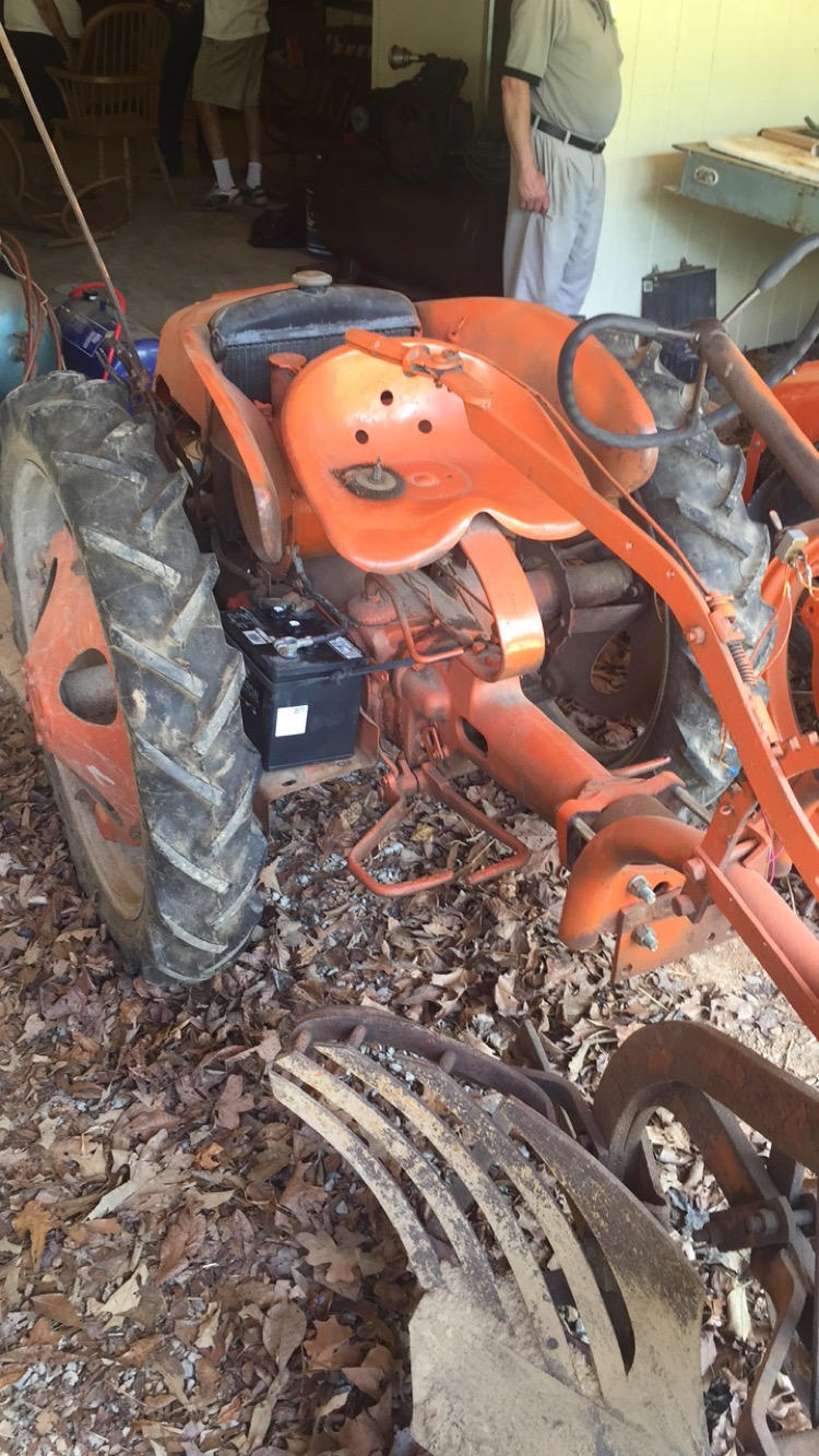

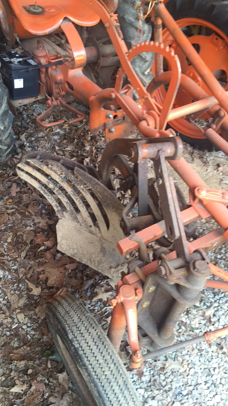

Must been a tall guy that owned it ,see where they put a spacer to make it longer.
nonetheless ,still dead.
Post Options Post Options   Thanks (0) Thanks(0)   Quote CTuckerNWIL Quote  Post ReplyReply Direct Link To This Post Posted: 06 Oct 2016 at 7:02am
Looks like G26451 to me.
 That torque tube extension could be an accident waiting to happen. The ears on the torque tub, not having a place to clamp to that is flat and solid, could very easily snap off.
It has happened on some G's before.

I see what you mean. Thanks for the advice. I was wondering why that spacer was there. Figured it was required when using that mounted plow. Did A-C make a factory spacer that would work better? I should probably take that off next chance I get. This one isn't running right now and I need to dig into it to get it going.

No, Allis didn't make spacers, sore knees did!
+1 on getting it off before the ears pop!

Is it ok for it to have a properly made spacer? Apparently it is/was a common practice to do this?

Took the seat off yesterday and hit it with a wire wheel on a grinder. "G26451" is what I read. It was still hard to read but that is what I got and since several of you agreed I am going with it. I was really hoping it was an early serial number, but oh well.
