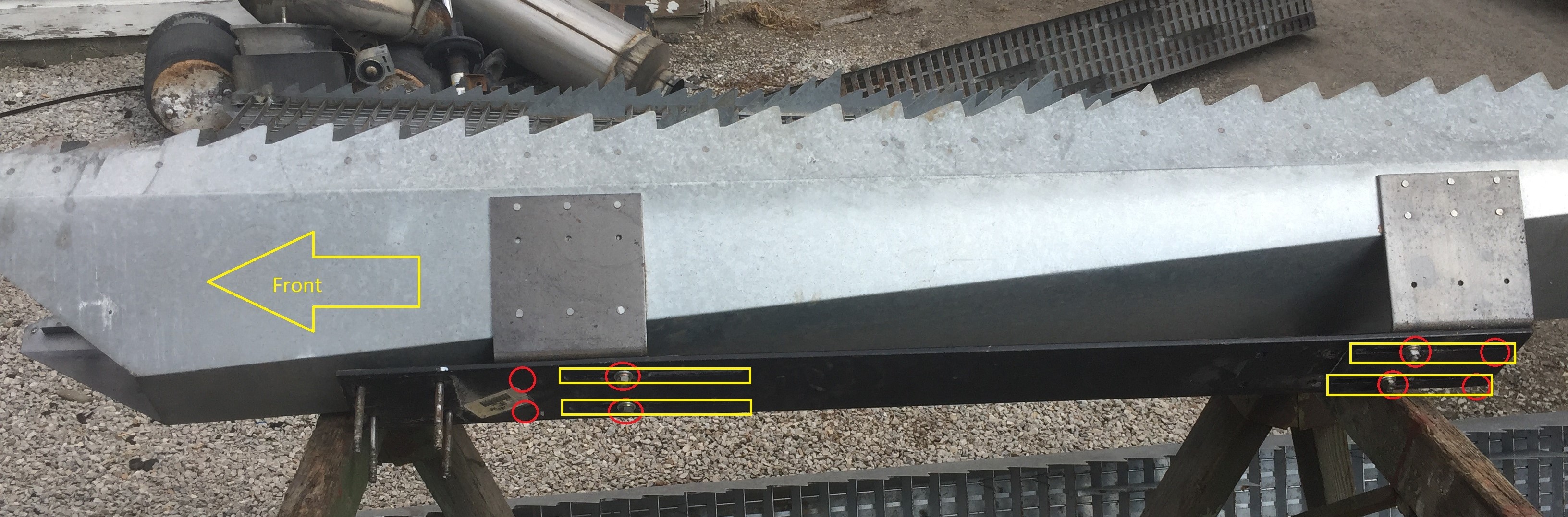

to be clear I took this picture, the round red circles are the mounting holes on the walker, and the yellow rectangle are the slots in the setback plate, which holes do I mount the walkers to the setback plate, the parts book shows a total of 16 bolts for mounting the walkers to setback plate so only 4 bolts per walker, I really need to get these set right these walkers I had to far for, and the look brand new. will be running beans this year corn next year.

when you mount them...put a little slime of grease inside the blocks. then take the drive chain/belt off the outside, tighten down the blocks on the cam, turn the drive cam by hand to make sure there is no binding, should turn freely. I always put one walker bottom dead center and tightened that one down, then the others should be right after that. but still turn by hand, if there is even a small catch or hard to turn spot, you'll tear them up again!

Thanks for the info, still looking for info how to mount them what holes to use.

mount the front first, then put the top block on the rear and check which ones matches up at the rear! not hard.

I guess my question what is the distance from the raddle chain to the front of the straw walkers when the straw walkers is in the forward position on the crank. So I don't mount them to close to the raddle chain and not damaging them. Since I got no reference to go by.
The original walkers junk had homemade brackets on them, looks they broke as some point so they welded 1/8 plate over the broke section on bottom and drilled holes to mount them to setback plate

I've never measured mine...DrAllis...do you know the measurement? that again is where the hand turning comes in, they are offset so not all of them will be in the same place at the same time. i'm sure we're talking 4 straw walkers here total? the cam should be down and back far enough as not to let any of the walkers hit the raddle. and appears they did the same thing I did when mine broke. dad asked me once why I combine at night so much? I told him I combine at night so that when something breaks I have all day to fix the stuff when the parts places are open! lol
