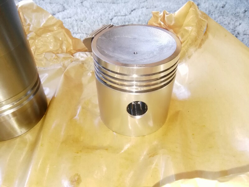

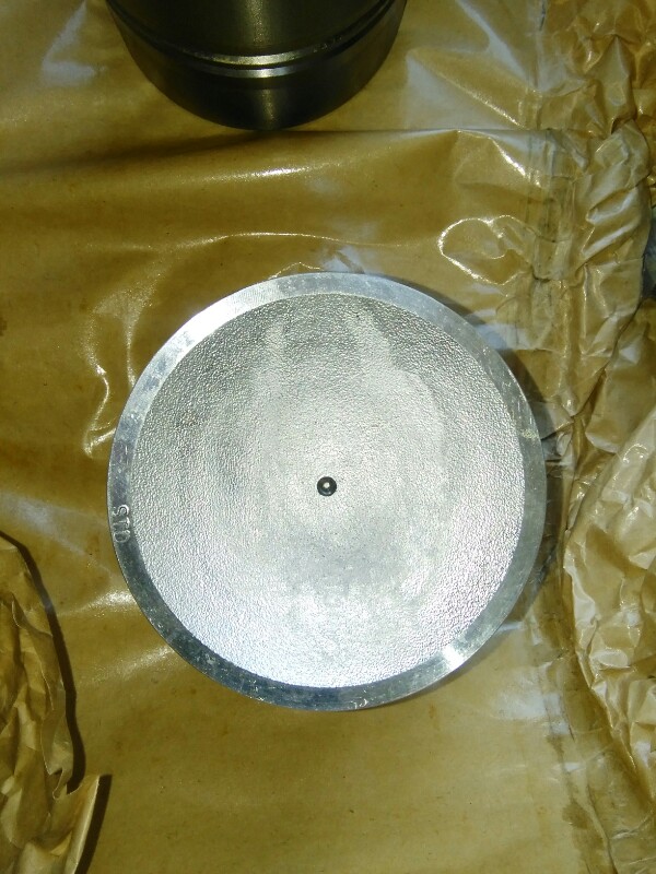

I bought a new piston kit and block together awhile back and nothing tells the compression ratio. I'm trying to figure out if I'm going to use them or not. I'm looking to make about 55HP with this new engine when done. It says JCC 1007P inside piston. Also has 6.6.2 inside of it. I'll try to get a pic.

If you can give the volume in cc of the dish in the piston and the height measurement from the the center of the wrist pin to the top of the piston some guys here can calc the exact compression ration.   Mike

What is the BORE ?? 4 inch or 4 1/8 inch??

4" going by tape measure. I came up with 60cc and center of wrist pin to top 2 3/8.

Find a 10cc veterinary syringe and start filling the bowl. That's the easiest way to determine the volume of the bowl.

What's the distance from the top of the wrist pin hole to the top of this piston? Or What's the diameter of the wrist pin? If you send me these and if you're block hasn't been deck, I can figure for you.

To accurate measure the cc's, you need a flat piece of plexi-glass with a small hole in the center. Grease the outer rim of the piston and set the glass on top of it, squeezing the grease. Fill with a syringe until full.

Top of wrist pin hole to top of piston 2 7/8
I can't find any informatoon on these pistons. I've sent two messages to Sandy Lake about piston options and no reply.
That doesn't make sense, here you said center of wrist pin to top of piston 2 3/8
Then you posted 2 7/8 from top of wrist pin hole to top of piston.
Distance from top of wrist pin to top of piston should be less than center of wrist pin to top of piston.

Just measures my wrist pin. It's .990 diameter. If your center of wrist pin to to top of piston really is 2.375, a 4" bore, and 60cc bowl, and .04 compressed head gasket thickness, you'd have a compression ratio of about 6.12:1. Also if you're block hasn't been decked (meaning it is the same height as mine).
I figured my reliance kit with a 40cc bowl and 1.863 from top of wrist pin hole to top of piston and a compression ratio of about 6:1. You have a bigger bowl (and it looks bigger in the picture too) and the piston is slightly farther away from the head to boot.
Sorry, just wne tthrough the same thing when I bought my reliance kit with D17 pistons. I figure they were .25 less compression than advertised.

Not happy with 6.12 at all. This piston kit will not be used. I hope to never open this engine again so I'm not settling with low compression pistons. Ill check measurements again when I'm back home.

Top of pin to top of piston 1 7/8. Center of pin to top of piston 2 3/8.

I'm getting 6.3:1 from a deck height of .518 and a 60cc bowl. If you're measuring with a tape measure instead of a caliper it's hard to be exact. Just 1/16 more distance from pin to piston top jumps you up to 6.7 compression. I'm guessing these are a stock WD45 4" piston kit at 6.5:1
