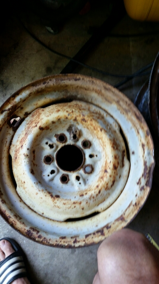

Here is a pic of one of the rims. They are definitely 5 inches (not 3) bead to bead.

That rim is fixable someone thats good with a wire feed can fix the hole then drill the
valve stem hole at another location.Then straighten the edges up with the Vice Grips,knock the rust off with a wire brush and give it a coating of POR 15 and you'll be ready to paint it.
I agree.  That rim can be saved.  If you a not confident in making these repairs yourself, a good welding and fabrication shop can fix it up for you.  My local shop gets lots of business from me, probably because everything comes back as good as new.

Yeah, I think I may just fix them. I was hoping for a faster option. Still wondering if they are the originals. Thanks a ton for all the help! This tractor thing is addicting!

They look like the original Series III rims.

early '60s chev car rims will fit too

yup look just like chebby rims to me.
