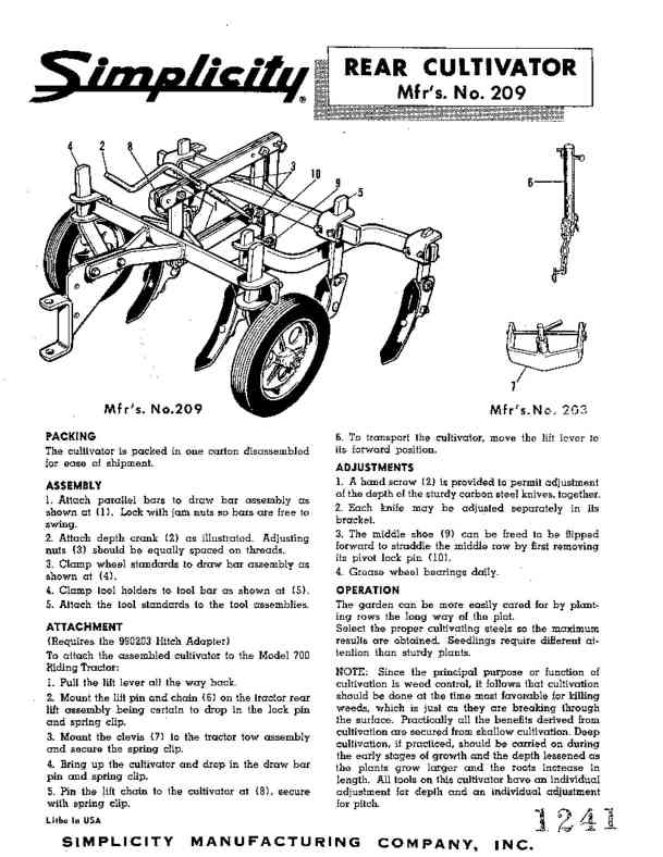

Does anyone have a adjusting crank for a 209 Simplicity cultivator? its #2 in the pic. thanks Tom

should be able to make one pretty easy!

yes it shouldn't be too hard, but I have to find a 7/16 left hand die.

not if you change the threaded part it screws thru. a couple nuts, one each end of a short pipe! it just hasta screw up and down!

A good machine shop should be able to turn left hand threads.  A quick eBay search came up with a die for $9.  I never realized it was left hand threaded.

half of it is right-hand and the other half is left-hand.

That complicates things a bit.  I have one in my shop, but haven't played with it enough to know.  It'd take a machinist with a lathe to turn that setup.  If you are on Facebook, there are a couple of Simp/AC garden tractor pages.  www.simpletractors.com has a classified section.  It's a club, so there are dues, but I think you can post a non picture ad and I know you can read the ads.

just get a adjustable top link for a 3 point - has both left and right threads - and modify to fit your use

Problem with that Coke, is the adjuster in question is 7/16" rod  and maybe a foot long.  For a cultivator that goes behind a garden tractor.  I do wonder though if a small turnbuckle couldn't be made to fit somehow.

I have 2 or 3 of those cultivator frames out back. I'll look today to see if there is a hand crank on any of them. Knowing where they have been for the last 30 years, it might be better to make up a new one Ermm

after working on it I think I can save the old crank,thanks Tom
